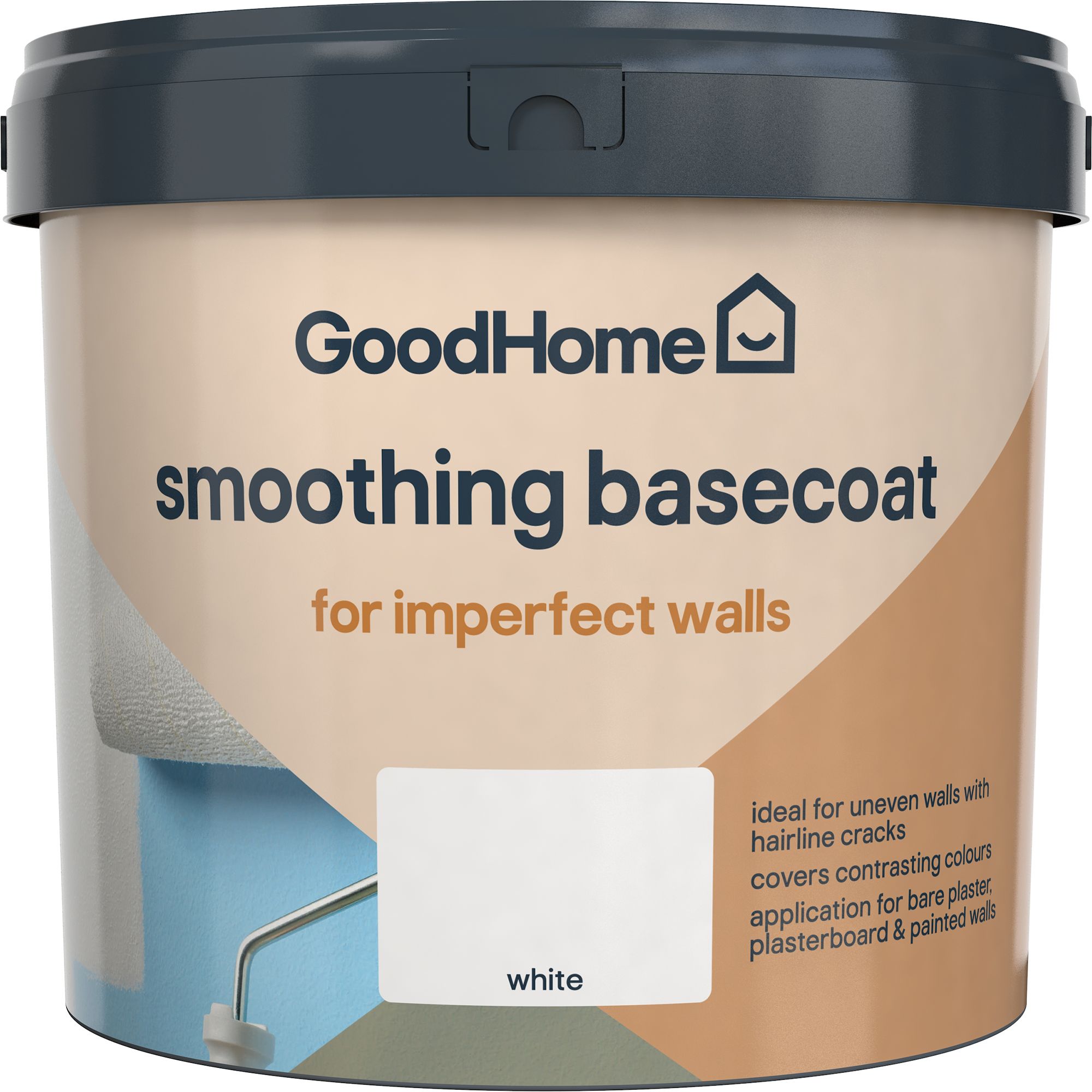

We’ve had some walls moved around and I’ve been tasked with painting it all, which is the limit of my DIY skills.
Will I be OK putting something like this straight onto bare plaster as a base coat (as the instructions imply) or do I need to faff about diluting emulsion?
Thanks all!
If it's new plaster, do you need to deal with uneven, cracked walls?
I'd lightly sand and then use watered-down emulsion (preferably not vinyl, but many people do). Tinted paint isn't cheap these days if it all goes horribly wrong
Posted : 24/07/2024 10:07 am

Posts: 3327
I think you're looking for something like this if you can't be bothered watering down normal white, not a smoothing basecoat you linked:
https://www.diy.com/departments/leyland-trade-super-leytex-brilliant-white-matt-bare-plaster-paint-10l/5010426824062_BQ.prd?storeId=1311&&&&&gad_source=1&gclid=CjwKCAjwzIK1BhAuEiwAHQmU3nNPCZ3xOtCR4v3bjVEbAofezTrSGyvcZDOSFUPIwP9J0m9iROsLCxoCQiwQAvD_BwE&gclsrc=aw.ds
I've used this on bare plaster without issue.
Posted : 24/07/2024 10:32 am
