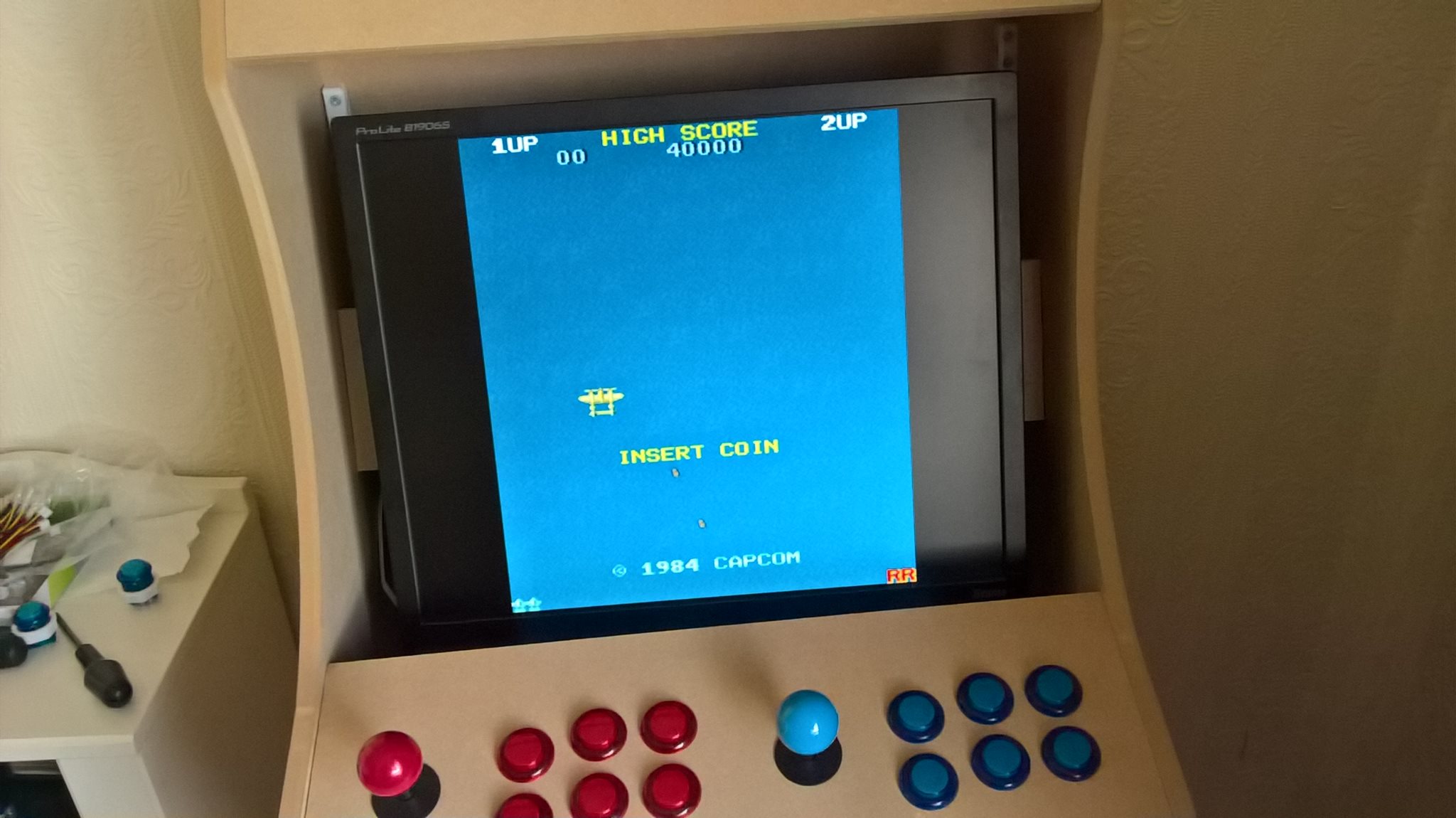

Well it's done. Cost a bit over £200 with wood, buttons, refurbed 20" 4:3 monitor and a free donor i5 mini pc.
Took a good 3 weekends - bit at a time rather than hammering the job out

Part way, working out internal space

PS It's farkin heavy.
18mm MDF sides, base and top section, 12mm MDF button areas on front. Big 20" old monitor (1600x1200 pixels so was good in it's time).
Wood £35
Fixings £20
Monitor £27
Controls £45 (includes all wires and a usb interface)
Vinyl Wrap £18
Stickers £12 (for 3 sets)
Speakers £12
Primer £8
28mm drill bit £5 (had all the other sizes)
Chrome Trim £8
Black paint £8
LED Lightings £9 For behind the Marquee
Perspex £10 Only £1 each but postage etc - cut to exact size
Marquee £4 Says Arcade and can be backlit
So about £221
I had a few bits in, like Monitor cable and extension lead. Used a hole saw to cut vent holes in the back. Hinges and a lock for a back panel so I can get access. Had all the tools other than a 28mm drill bit for the buttons.
Vinyl stuck down OK, but bubbled a bit when fitting the buttons, which was fixed with the heat from a hair dryer - all sorted.
Decided not to use a router to put grooves in the MDF to fit T-trim on the ends, and bought car chrome self adhesive trim - just used extra glue on the sharp bends.
The MDF dust was bad enough working outdoors, and didn't fancy all that from a router with a slot cutting edge.
Really pleased with it, not sure where it will go, but it will find a home in the garage, and come out when we have friends and family round for parties.
Currently has over 1000 Mame games (many more with duplicates/different editions), Spectrum games, Mega Drive and N64.
Mame is driven by Launch Box on the front end that looks well polished (menu system with screen shots of the game and a 'history' section.
