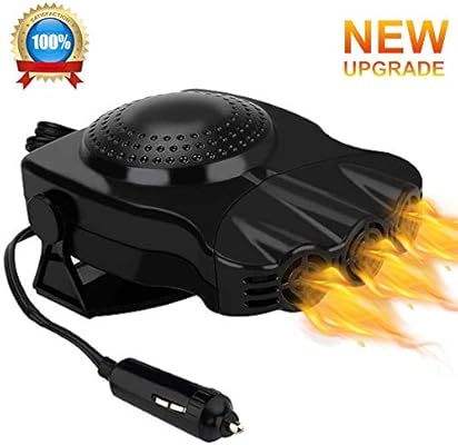

rather than spend that, are these any good?
windscreen demister
id guess theyre crap but thought id explore all options before splashing out. think its probably just under the cost of taking to webuyanycar, so if these are indeed tosh, we'll get it done and cross our fingers theres nowt else looming.

I had one in a Triumph Herald 'back in the day'. To cut a long post short: "Don't bother".

I had one in a Triumph Herald ‘back in the day’. To cut a long post short: “Don’t bother”.
I had one in a Triumph Spitfire 'back in the day'. Unless they have improved significantly since then: "Don't bother".

I had a citroen c2 with a leaking rear end (fnar fnar etc) which meant the carpets were getting saturated so it was completely misted up every morning, you'd wipe it off and it would mist up again before you got going. And it was often frozen on the inside as well.
Obviously being a citroen the air blower didn't work so I bought one of these. Long story short, it will clear a very small patch on the windscreen directly in front of it after a minute or two, but do nothing more after that.
Probably because they're only 100-200w whereas a normal fan heater is more like 2000.

Probably because they’re only 100-200w whereas a normal fan heater is more like 2000.
thanks, good to see real world figures that show why theyre so crap then.

Looked at one of those myself a few days ago as my Audi A4's blower has gone and we are weeks away from replacing it so cant be bothered with the garage. General feedback was that there simply wasn't enough power from the car outlet to make it do anything worthwhile and the cables are supposed to get bloody hot too.
