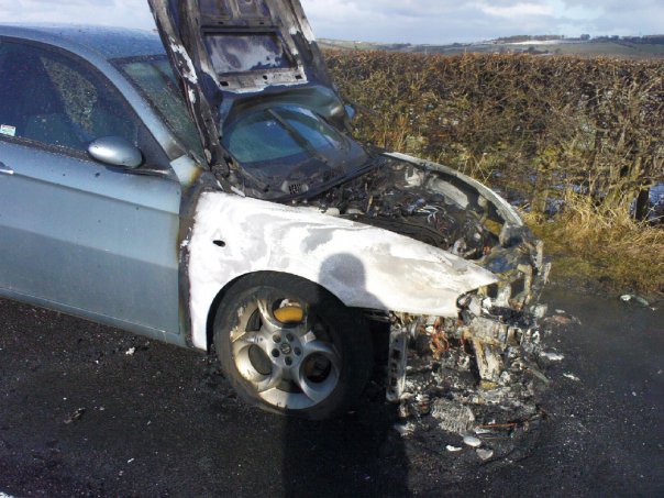

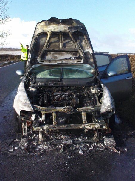

Buy it. It will have electrical gremlins. It may be starting to rust (subframes, radiator mounts, potentially cills). Get good insurance, possibly a fire extinguisher.
(I did say he shouldn't drive it, but he has the stubbornness of a Vogon and the mechanical sympathy of Bruce Ismay.)
