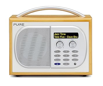

I had this for weeks. It turned out to be the power supply in this...
Posted : 08/07/2015 5:59 am
