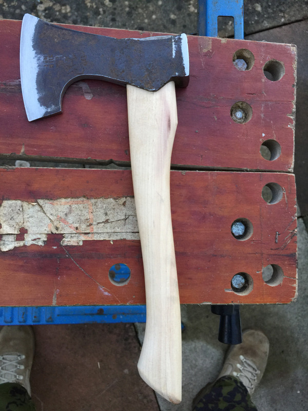

I know a fair few here have a splitting axe and while my x17 and x27 do most of the work I have a small collection of real axes that I've been rehanging, and thought I'd share some photos.
first of a 700 gram hatchet. I got gifted the head by a guy in Canada and although not marked he is confident its likely a swedish origin head. he steel is very hard. I hung it on a 20" smedberg haft and its brilliant for kindling or around the garden.
that was the first I hung. Recently i did this 4.5lb Hults bruk. it had an odd eye thst was 1 1/4" wide. I couldn't find a haft to fit anywhere so in the end i modified a pick axe handle. that had the width but needed more length so after planning a flat surface I added a piece of ash and achieved a decent fit. the haft is awful though with grain run out. I have another which is better but chose to practice fitting with the bad haft first. pretty happy with the result.
haft got a light scorch then the BLO.
Then the other day I finally hung this. Its an American head by one of their decent makers - Kelly True Temper, a Jersey pattern felling axe, about 3.5 lbs. hung on a 28" ash handle, light scorch and BLO.
hope the photos embed ok....google can be a pain. I have a few more photos if people want to see more.
I've a few more heads to hang including a wetterlings and a german sandvik just bought.
So, let's see what everyone else has!

work in progress pictures... a few I think. If you want a 'How to hang an axe' then I'd suggst Buckin' Billy Ray on youtube, but lets see...

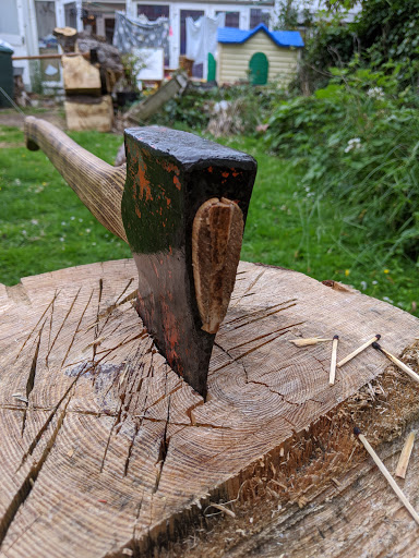

So this is the end result we are after, a head hung straight. DOn't assume it will be by itself, the hanging process is a game of shave, fit, inspect, remove, repeat, and you need to keep checking for straightness by looking down the edge like this.
all 3 of my axes have needed more off the rhs of the haft to achieve a straight hang...the older and more vintage or hand made a head is, the less likely the eye will be straight!
we also want this, a no gap tight fit, wedge well swallowed. I follow Buckin's instructions and go for the haft out the top a bit and aim to whack enough wedge in to 'swell' it over the top of the head. this photo reminds me...I've not yet banged a cross-wise metal wedge in, although no real need as the wood wedge is glued in and the head tight
we also want a tight no gaps fit around the bottom

the ultimate in tight fit arond the bottom is NOT with the head hitting a shelf, it should be sliding further and further on as you hit the haft, getting tight and tighter and giving a bit of curl
here's a cross-wise metal wedge
Posted : 01/07/2020 8:10 pm

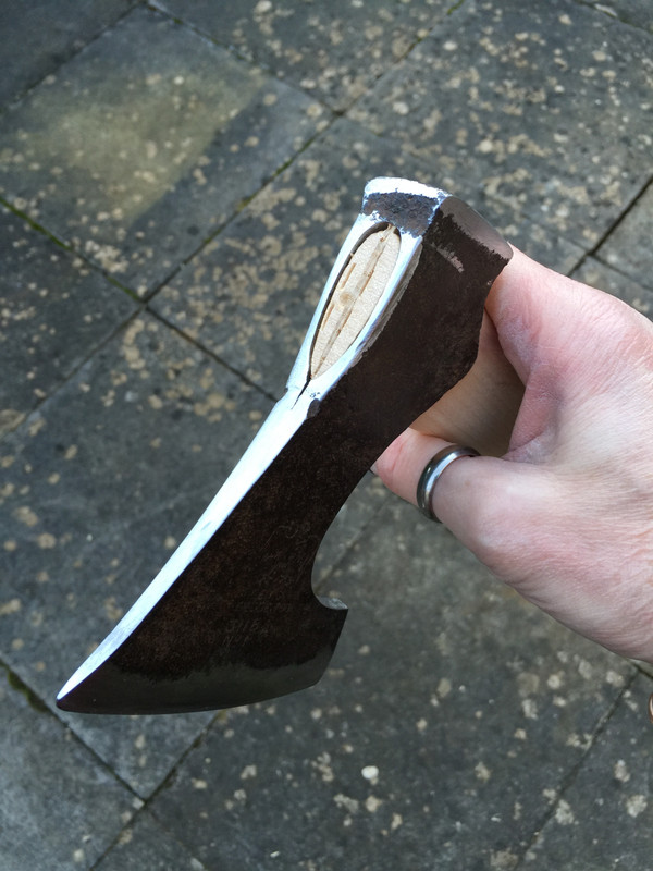

[url= https://i.postimg.cc/zfXDb7NW/A966-E342-417-C-431-C-9066-1-D7-DC7895819.jp g" target="_blank">https://i.postimg.cc/zfXDb7NW/A966-E342-417-C-431-C-9066-1-D7-DC7895819.jp g"/> [/img][/url]
[url= https://i.postimg.cc/JzQ4zgfM/C9-FFC654-FC64-4530-84-EF-9233-C1-B7-D477.jp g" target="_blank">https://i.postimg.cc/JzQ4zgfM/C9-FFC654-FC64-4530-84-EF-9233-C1-B7-D477.jp g"/> [/img][/url]
Here you go - for the moment I’ve just sealed it with a bit of Renaissance wax.
Posted : 01/07/2020 8:14 pm

Patience patience. It currently takes me 1 to 2 hours. Each time you knock the head on look around the bottom at the haft and check for gaps, user a pencil to mark the high spots and the line of 'fit this far'. Knock the head off and you'll also see the marks on the haft that are the tight spots, take a look, take a little off, refit.
I use a spoke shave, just a cheap one but I've sharpened the iron on a whetstone, and I use a shinto rasp. Well worth buying both! Then it's easy to remove wood and you'll not get frustrated.

Haft selection. its all about the grain. ideally the haft is all sap wood or at least minimal heart wood. with grain going front to back the haft is stronger, this is the smerdberg that went in the hatchet
however what is far more important is no run out. i.e. the grain should run right up the length of the haft and not across it. if it runs across, then the haft will break.
take a look at the haft on the big Hults Bruk, as I've scorched it and picked the grain out you should be able to see it runs out badly, this handle won't last

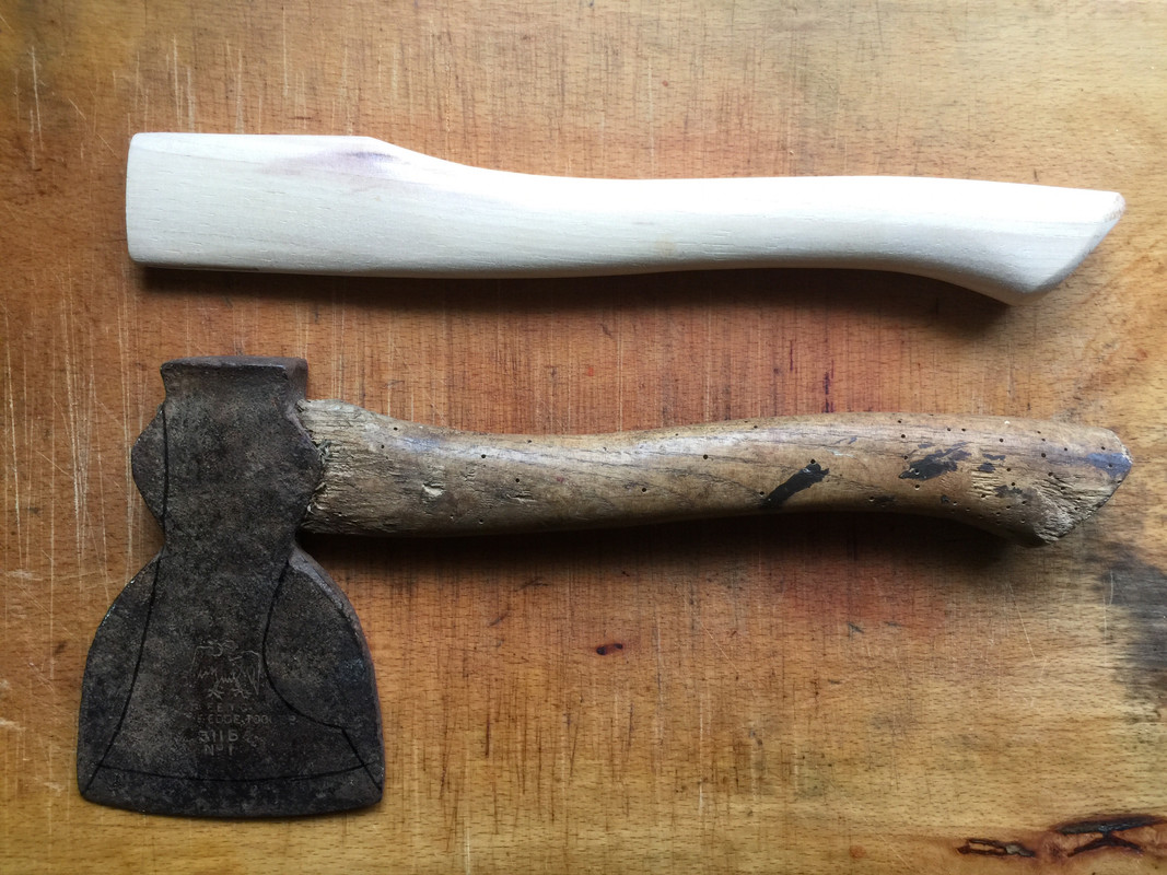

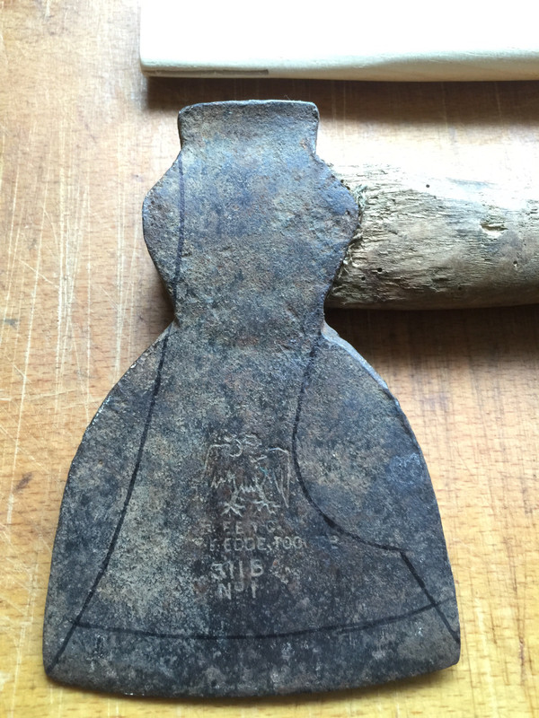

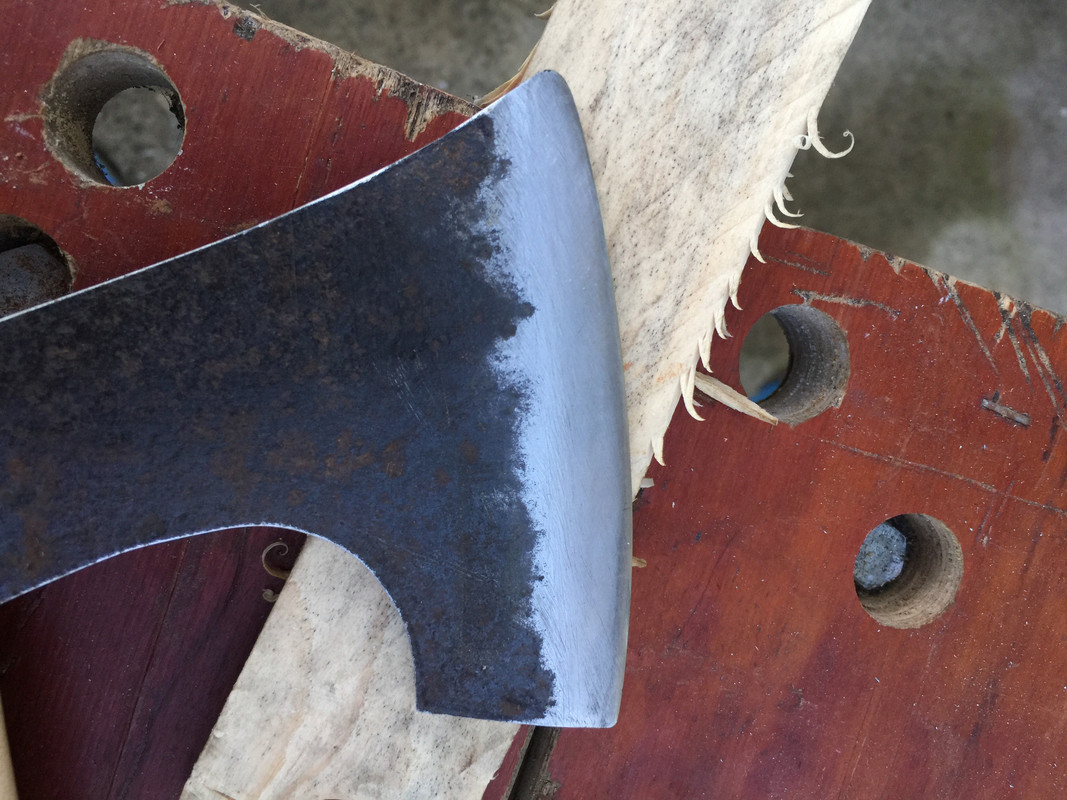

this shows something i do that helps me, last thing before smack the wedge in, take a file and just put a little chamfer on the top of the kerf s its easy to start the wedge,
and this is something i tried that didn't really work. I was trying to take a little surface rust rust off and get a black finish. I'd noticed when splitting oak, a day or 2 later my x27 was black, and realised the tannic acid in the oak was the cause. so i picked up a load of oak sawchips in a bucket and added some water. the heads stayed in a week and blackened beautifully, but it wasn't hard and rubbed straight off.
Ah yes....handles with 'shelves' not a gradual fit....this was the hatchet early in the fit... not ideal!
it got better but not perfect
in my defence that head had some particular challenges....but I'd do better now. (although it has been darn tight for 2 years now so I didn't do too bad.)

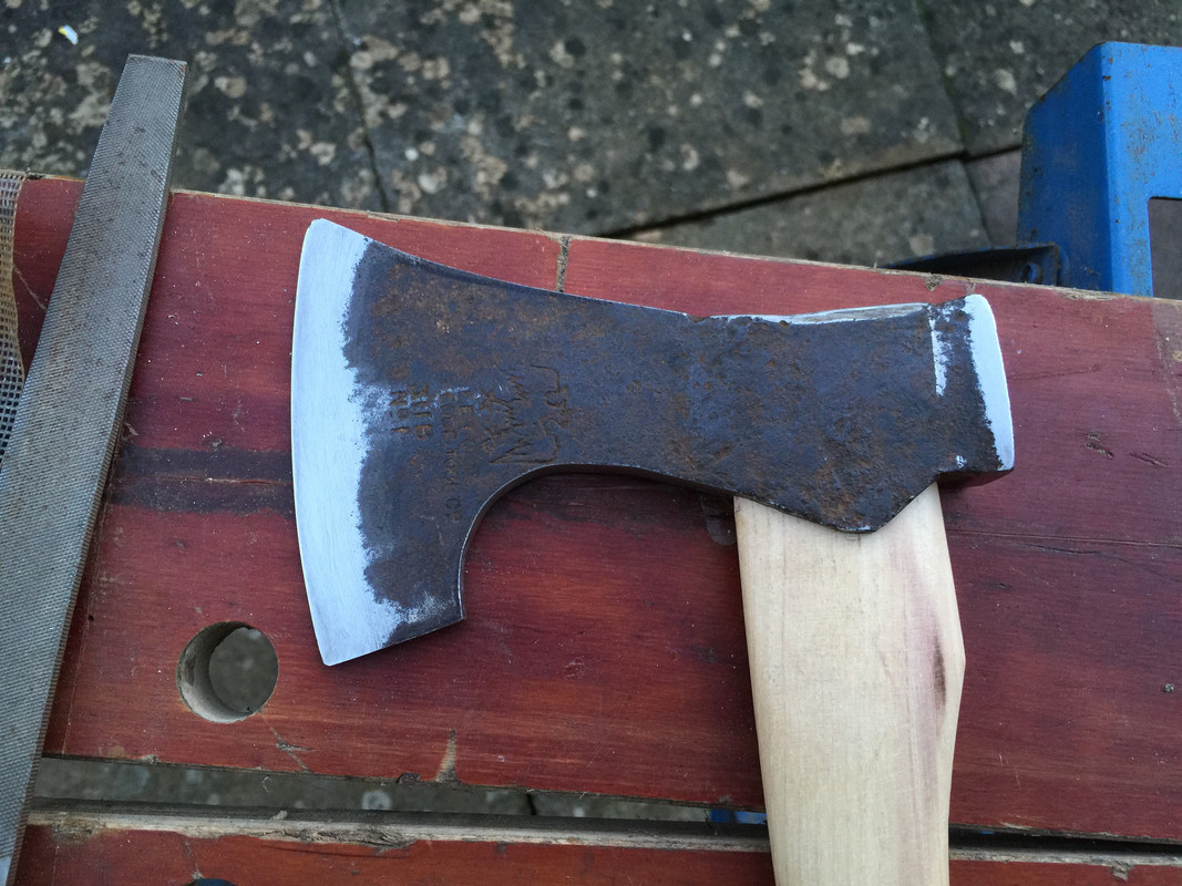

Its not finished yet, but its a 4.5lb Sandvik, made in Germany. Sandvik is a town in Sweden that is the home of their steel industry, think Sheffield but Swedish. The original Sandvik axes were made by Wetterlings, then after the merger with Bahco manufacture moved to Germany and Helko Werk, that is what this will be. Still a very fine head. So far the head has has several coats of rust killer, and that's it.
sandvik head
Now its hung It'll get a polish and a sharpen. As for the hang....I decided I wanted a straight handle again, and they are hard to get so I went with a pick axe handle, very good grain on it running the length of the shaft, Ash.
a quick file to clean the eye and put a teenie chamfer on the eye.
eye
roughing out where the eye and 'shoulder will be on the haft
haft
haft
haft
haft
from there on its lots of spoke shave/shinto rasp work and is basically the same as fitting a normal handle. fit, see where it sticks, see how straight it is, mark the haft, knock the head off, shave more off and repeat.

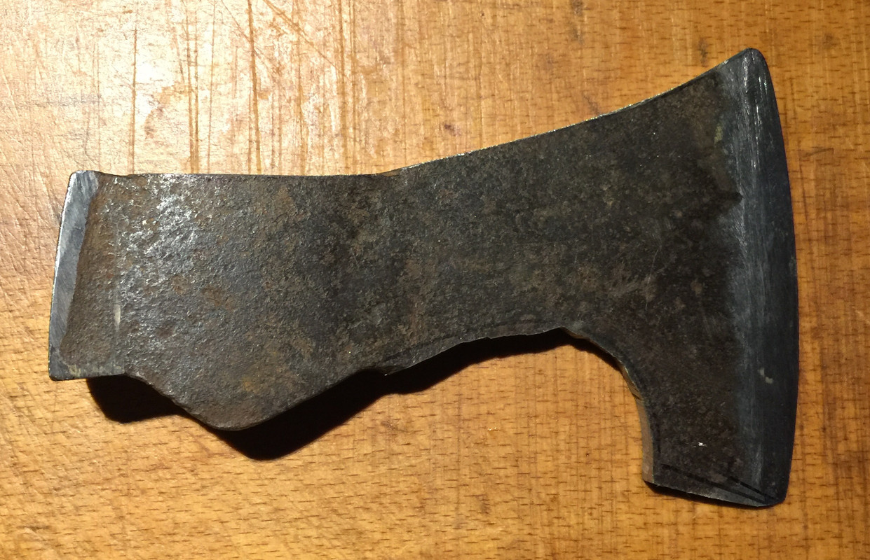

I bought another Sandvik. no country marking so mu guess is Sweden ....Wetterlings forged
I've also got another HB head that I picked up, so along with a Wetterlings that's 3 projects to get me through lockdown #2.
I also need to finish this, but I've hung a 'no name' made in sweden
Ash handle, think It ended up about 29"
