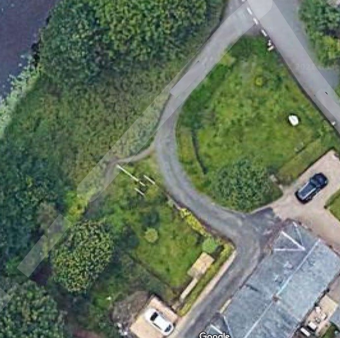

Looking for some advice about driveway surfacing as ours is in a bit of a mess.
We have a shared driveway, servicing 6 cottages, adjacent to the canal.
hopefully this pic works:
driveway pic
top left corner is the canal running NE/SW, bottom right is the start of the row of cottages in the same orientation.
You can see the driveway curve off the main street (main street in top right, running NW/SE). between the road and where it starts to curve toward the cottages is permitted access from scottish canals. They don't maintain it, but want to agree to what we do with it. That part is level.
the curve toward the cottages slopes at somewhere between 15-20 degrees, then curves at the top 90deg toward the south west and runs along the front of the cottages.
originally, a long long time ago it was cobbled, in one area where the surface has eroded, these are exposed,along with the asphalt that was laid on top of them, and the gravel that was laid on top of that.
Canals want something that will not create a point source discharge, so a permeable surface (ignoring the very old asphalt layer) we want something that's going to last more than a few years.
plan will be to dig out the slope to remove the old asphalt and get down to something to key into. We will need to provide drainage from where the car sits across the top of the slope to direct it down the side of the slope and provide some sort of storm catch pit at the bottom of the slope, as currently rainwater rips a channel down the slope.
however, what to surface it with? gravel isn't going to work. resin bound maybe, but there's a lot of turning potentially tearing it up at the top of the slope, will it cope?
I did think of those concrete reinforcement things used for grassy areas, but I'm not convinced that it would work well either.
tarmac would be the obvious choice, but I doubt canals would agree to that.
would be nice to not have something that's a literal ice rink in winter too. we put a top coat of tar and chippings over the gravel a couple of years ago and while it stabilised things a bit and lasted about two years, it collected water downlsope, which made for a couple of squeaky bum moments sliding toward the canal bank.
any suggestions welcome.
thanks

Any chance you could all club together and buy the land off the person where the black car is parked?
Then you could put a new access into the main road, put down whatever road surface you like, and sod what waterways wants because you’re not using the permitted access any more?
That land is communal, we just let them use it as theirs. However, it's a conservation area so weird planning, and theres about a 5 ft drop to the road from there.
