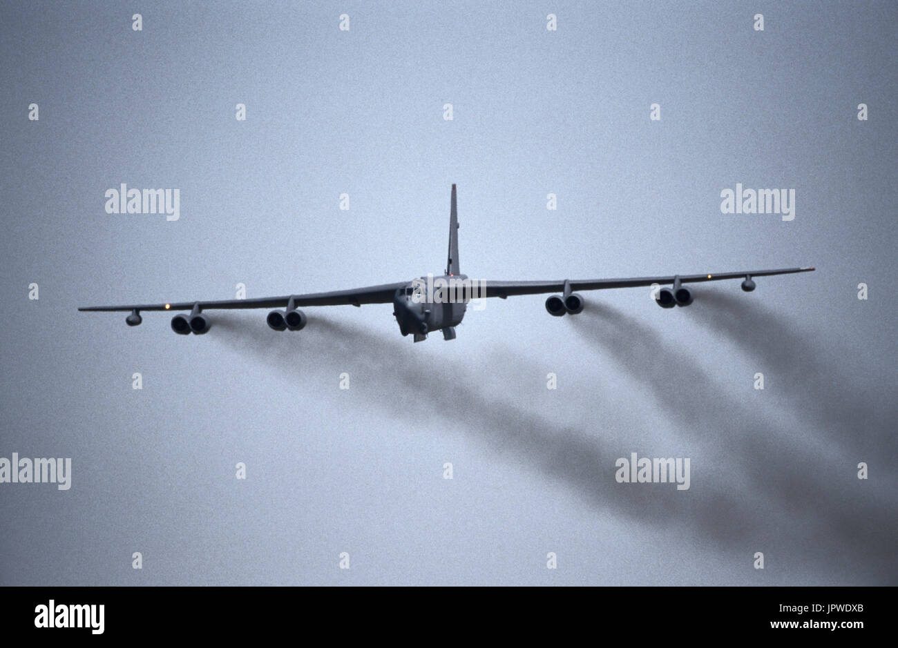

In a number of cases that black smoke was the result of water injection. Although it increased power for takeoff in turbojet or low bypass engines the water lowers the temperature and the engine burns "dirty". Modern high bypass engines are a different story and much cleaner (although still very polluting in the grand scheme of things).
Posted : 12/01/2021 10:45 am

B-1, first flight 1974, might need a better example for 'modern', although 'modern' jet bombers are a bit thin on the ground (air?)
Posted : 12/01/2021 10:58 am

B-1, first flight 1974, might need a better example for ‘modern’,
The chem trails from a Stealth Bomber will be invisible.
