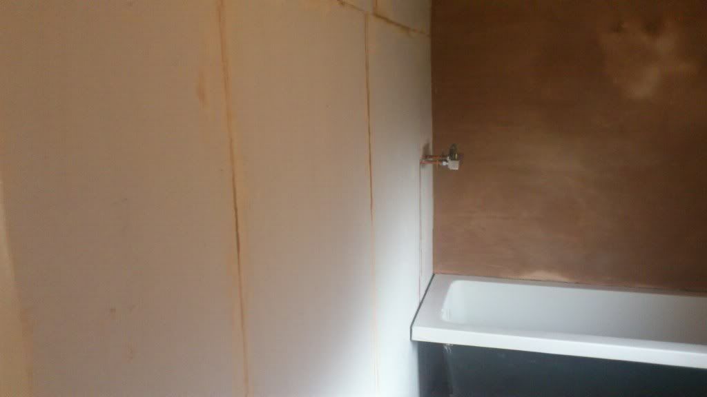

My lazy-arsed plumber, decided when not under supervision ,that he'd changed his mind about chasing in shower feeds, and instead wall-mounted them, with instructions to to double board the wall instead.
(I am so retraining as a plumber should a redundancy package come along).
(Crap photo, sorry, and not sure what insight it will offer)
The first level of silver-line board has gone up, but I'm chuffing loathed (and I won't) reboard again, losing much needed space, so I'm just going to double board the width of the bath (he's chased out the other wall).
However, I'm thinking waterproofness, and not sure what to do next.
I was thinking of some 'tanking' business, over everything.
Then installing hardibacker onto the area that needs 'lifting out' to accommodate the slightly exposed plumbing, and bath gap now he's chased the opposing walls.
Then, the 'lip' will be hidden by the shower screen (apart from any area above shower screen of course)
Can I just use normal bonding to attach the hardibacker to the plaster? Seems wrong to just screw on.I was all geared up for attached HB to the floor using adhesive/schrws, but not sure what to do in order to attach it to plasterboard on a wall.
Any suggestions, from knowledgeable folk?!

Those are just normal silver backed plasterboards along the left. They are untreated.
For the width of the bath (ish) I need to add another layer of board, to cover the pipes, but also provide depth to sit the bath into the opposing wall which has been chased out.
That's it, really. I'm just not very good with words 😉

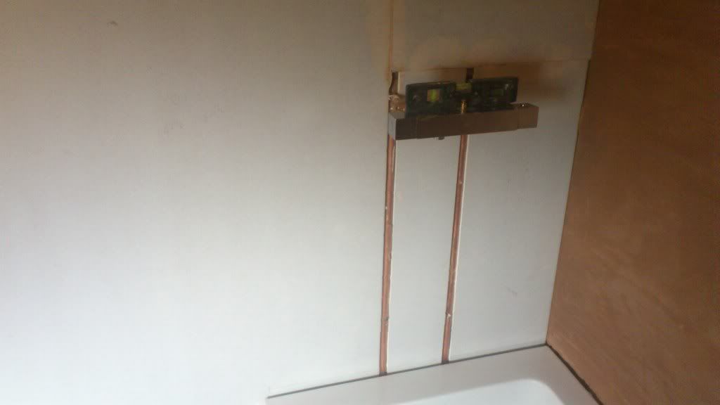

Ok, firstly, why are you using foil backed boards and how did you fix them?
Secondly, I can't see any pipes on the back wall, so assuming they're not there yet. Why can't you just Chanel out the wall for the pipes? I'm assuming 15's? Fill over with bonding or drywall adhesive, them tank the whole area. Are these walls being tiled? If so, there's absolutely no need to skim them
Posted : 07/03/2014 9:16 pm

I think if I am understanding you correctly , the new plan is to overboard and tile up to a line on the wall where a shower screen will be fitted? As opposed to continuing tiling past shower screen and it being fitted on top of tiles as per a normal job.
From what I can see from the photo would I be inclined to bring hardibacker out past the bath, tile and fit shower screen on top of tiles, you will obviously have a return back to the wall, the alternative is to double board the wall as has been suggested.
The distance between the tiles at each end of the bath is dictated by the length of the bath, so I can see why the plumber has not chased the pipes in as you need to close the distance anyway it serves no purpose.

Foil backed boards are designed to cope with a small amount of dampness or vapour, penetrating in from behind, i.e. a solid wall etc, not for bathrooms. That in itself is not an issue in your case, what is a problem is the drywall adhesive. It doesn't stick to the boards very well at all and they need to be screw fixed to battens ideally. If you tile them, they'll probably break loose, I certainly wouldn't tile them personally.
As for the pipes, just chase them in

Don't use plasterboard of any description for the second layer. Use 'Marmox' multi-board or similar.
Here:
[url= http://www.marmox.co.uk/products/marmox-waterproof-insulation-board ]Marmox[/url]
Ahhhh, penny's dropped with that. So essentially, there's no point in any of the other plasteboard, other than for where the bath is going, other than for the sake of preventing a lip (which I'm not bothered about as the space is much needed in foreground of pic).
Right can I then:
Rip out plasteboard, up until a 'safe' distance from bath.
Put 'tanking' or sealant whatever over the platseboard.
Then put Marmox/Hardibacker over plasterboard using adhesive?
(FM thanks, but battens out of question - anything better than bonding?)
Posted : 08/03/2014 7:25 am
Why are we tanking walls that are going to be tiled? It seems the latest done thing for some reason. I'd just use an mr board then a proper waterproof tile/adhesive/grout combo.

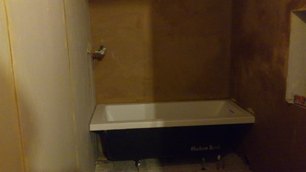

Better pic.
You can see that boarding full length of room was daft, so I'm going to take down everything up to about 6" away from bath.
a) How do I seal the edge of board that will be left and
b) Can I adhesive the cement board over the remaining board (i.e then covering remaining pipes).
Thanks, and I feel like such a needy arse, but genuinely stuck for people to ask.
