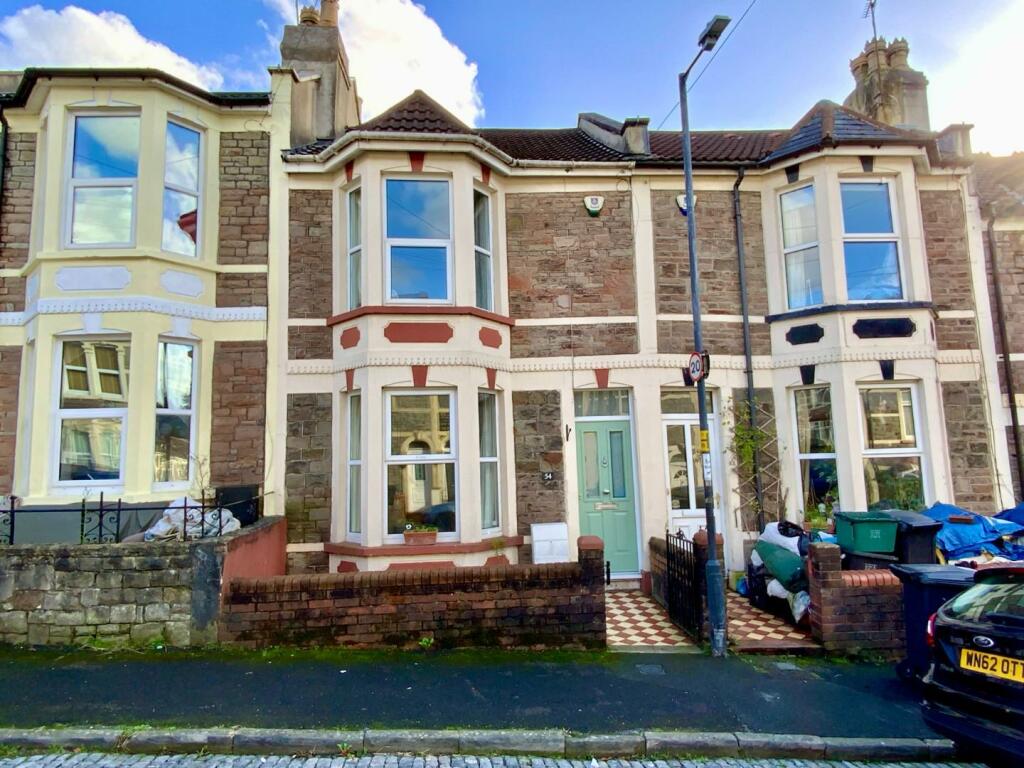

Going by that photograph that's stone of some kind with probably brick internal wall but it should be breathable due to the hungry looking joints, water must be pouring in through the gaps
If you're not sure of what your house is constructed with IE brick !! some folk may run circles around you
Repair the parapet wall by all means but that's only a wee part of the problem. Nowadays parapet walls get covered all over with lead to properly seal the parapet wall
There's a chimney looking dodgy in the photo maybe a neighbour and it's been plastered up to hide it but it looks like it may go at some point
Any coping stone up there should be mechanical fixed with stainless brackets rather than relying on a bed of mortar on its own

that photo isn't actually our house, but it's similar and nearby.  The houses are all brick - the stone on the front is just cladding. Our chimney is exposed brick too.

you mean the fake 'mediaevel castle style' stuff all over the front?  Almost every house within half a mile has got that! It must have been the fashion in the 1890s - in our area, probably 95% of all the houses, and in inner city East Bristol generally, must be at least 75%....
Why not enjoy a relaxing stroll through one of the neighbourhoods to soak it all in? 😀

Surely that isn't retrofitted stone cladding, it is the outer skin.

The houses are all brick – the stone on the front is just cladding
Not so. Classic Bristol Victorian/Edwardian style. Proper stone with bath/Portland stone sills and bays. Solid wall with a brick inner leaf and all resting on sweet FA. I lived in one for 20 years.

Slight hijack, but I'd be interested in roofer recommendations in Bristol. Had the lead flashing redone on the chimney last year but still having water leak down the stack in the loft, soaking some timber beams.
After someone to take a look and give an honest view/quote on repair or new roof. I may as well be going off Amazon reviews based on the varying opinions of sites like TrustMark, Checkatrade, Nextdoor etc.
