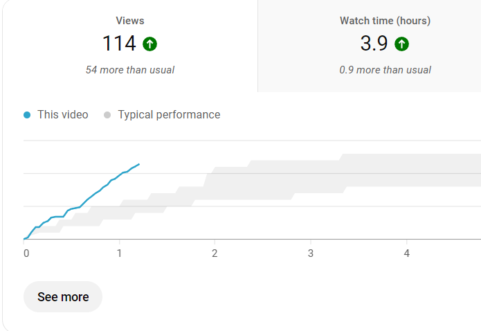

Posts: 13369
Latest video is out :
I just checked the stats and it turns out that only 4 of you are watched the last one so I might not keep updating this thread with the links. If you do watch and want to be told when they are released then let me know, otherwise I will rely on you being subscribed and getting the alerts from there.
[url= https://i.postimg.cc/fLkgfY84/YT-Stats.pn g" target="_blank">https://i.postimg.cc/fLkgfY84/YT-Stats.pn g"/> [/img][/url]

Posts: 1268
I’m subscribed and await each episode eagerly 🚙 👍
Posted : 03/06/2024 7:14 am
Posts: 3327
I've watched them all but no longer via the links here.
Coming on well, keep it up!
Posted : 03/06/2024 8:01 am
Posts: 13369
Cheers guys. I am glad you are interested / bored enough. More'glass bring delivered this morning so i should be able to finish the second wing and get them both glassed and with filler on.
It is getting close to actually having the body plug complete. Probably just another 72,000 hours of sanding to go.
