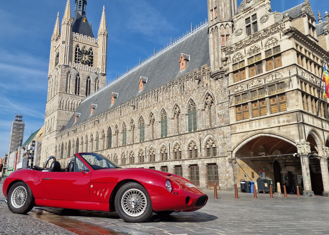

A mate does these based on old taxis
Posted : 09/02/2023 9:27 am
Posts: 13369
[i]
Yep! This is a 'minor bodywork alteration' and not a 'seriously modified vehicle' or whatever the correct terms.
Just the same as my Z3 but with a better base car.
