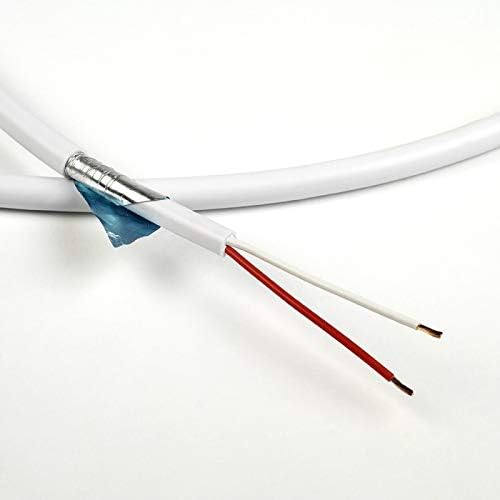

I was jus wondering about the best way to strip them for banana plugs?
It's not abundantly clear..

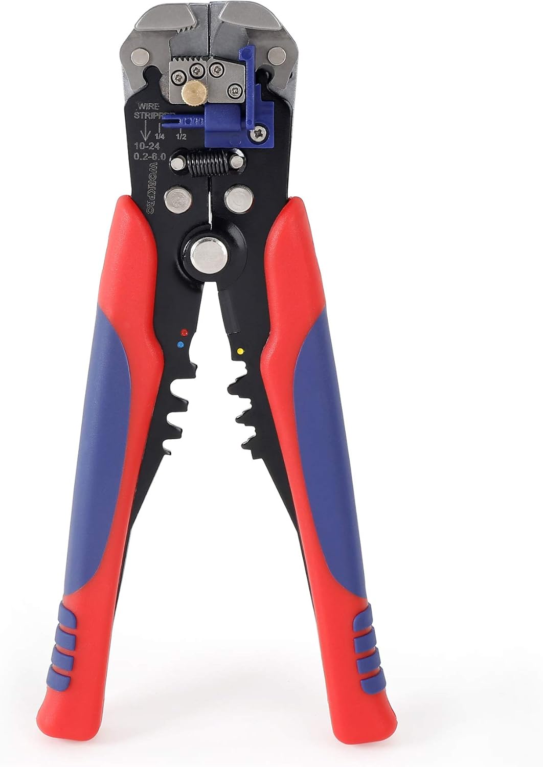

Posts: 4985
Looks like there are 3 layers of outer you need to cut through.
Rather than a knife, I'd use one of these and do it a layer at a time.
Posted : 05/12/2020 8:51 am

Adjustable Cable Stripper to remove the outer sheath without damaging the inners.
Posted : 05/12/2020 10:39 am

You will need a DU blade to get through the 5G tinfoil shield!
I would split down the middle about 10 cm, then remove a layer at a time with a knife in the usual way.
Posted : 06/12/2020 4:32 pm
Posts: 15068
A sharp pair of scissors and a steady hand.
Stanley knife might help split/take the outer shield off.
Posted : 06/12/2020 5:47 pm

Suck ma bawz.
Soooo.... You go a shielded cable (that speaker cable doesn't need.)
You chopped the shielding away at the end... So you now have an unshielded cable... Good job.
Posted : 08/12/2020 12:25 am

Soooo…. You go a shielded cable (that speaker cable doesn’t need.)
Remember when having your phone near the speaker made it go mad when you got a text?
You chopped the shielding away at the end… So you now have an unshielded cable… Good job.
Yup, that renders it pretty pointless. Surely you should earth the shielding at the speaker (which wouldnt work as cabinets arent metal) and the amplifier.
Surely the biggest hurdle is having to convince the artists to go back and re-master all their recordings using shielded mic cable rather than meerly starquad with XLR ends?
Posted : 08/12/2020 11:35 am
Posts: 10315
Actually it's perfectly valid to only connect the shielding at one end if you want.  It's also valid to not connect it at either end.  It depends what you are shielding against and how the noise is being injected (common mode/differential mode).  The shielding is much less effective if not connected at either end but it will still do something against some types/sources of noise (but not all)
It is also of course a complete waste of time in this context.  See also the noise insulating feet on that ethernet switch FFS.  Part of the enjoyment of audio is how much money you burn on stuff that does nothing and if that alters the 'sound stage' then so be it
Posted : 08/12/2020 12:04 pm
