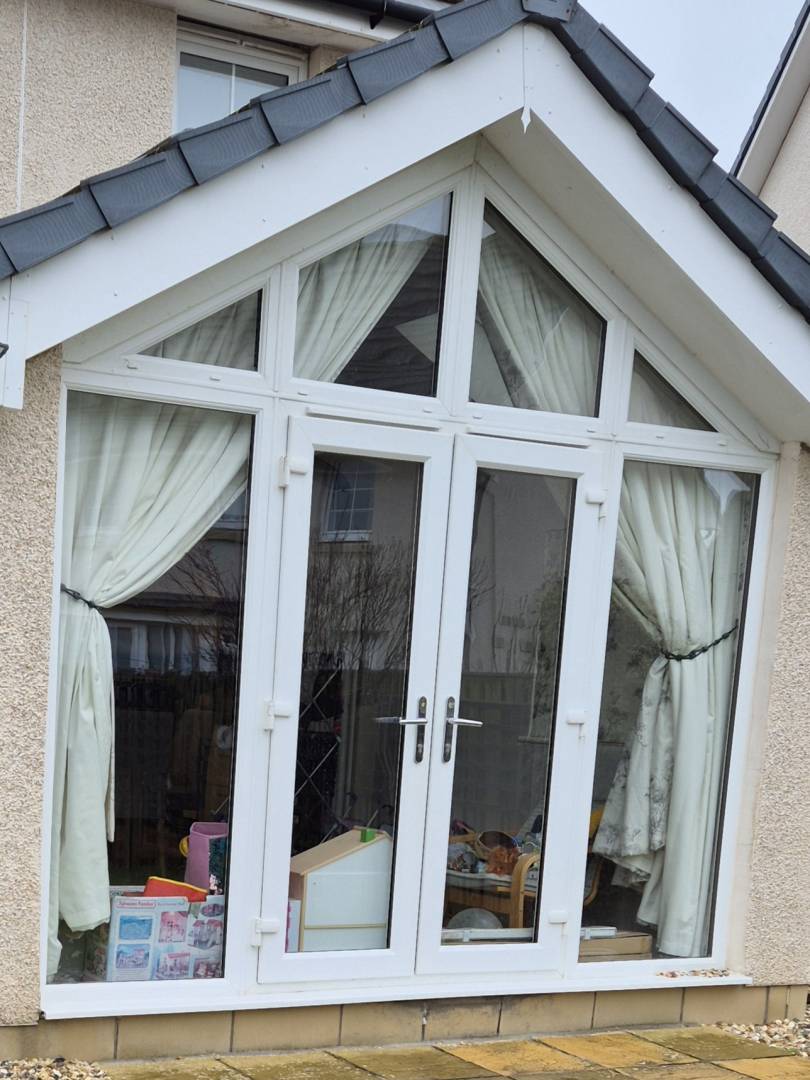

We have this window at the rear of our house and it's complete junk. It flexes and is full of gaps. Also there's a weird half step on the inside. It's installed in an extension built by the previous owner.
We had a "design" appointment with a large reputable(?) firm. All they managed to come up with was something pretty much the same but with wider doors. They talked us out of any other option like bi-fold doors, off centre door, low/rollover threshold, plus lots of talk about building warrants required for changing the step.
One option I'd like to explore is a large unbroken (in all senses) triangular window at the top, then bi-fold or patio doors underneath. To do this will require some form of cross-member at the top of the door. I've seen examples online but it was something the company we had round dismissed quite readily (I think because they can't do it themselves)
Can anyone advise on what options we have?

You can see in the pic that there is no continuous section at the base of the upper windows so it's not surprising they flex. There must be some kind of plastic box section with a steel box section inside it for this kind of situation. Unfortuntely I know SFA about plastic windows and doors so can't really help.
Posted : 21/02/2025 7:58 pm

I would take the pic to a local indie window manufacturer, someone who actually makes windows not a reseller, they ll give you honest advice.  Also, just walk around locally and see what others have done on a similar configuration.
If it were me, I d go for 1 piece of triangular glass above a horizontal support, sliding doors below.  White pvc with biggest glass profile that will fit in frame.

The double doors look out of proportion to the side panels. I'd look at larger conventional doors with fixed panels and a two-piece triangle above.
Talk of low thresholds would push me towards a builder for the lot
