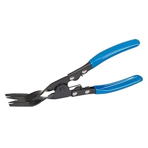

Posts: 4132
highly recommend one of the cheap ebay trim removing kits, should have one of these:
and a selection of plastic levers. It's one of those jobs that the proper tools will make a lot more pleasant.
Also, buy replacement clips from the dealers if you break any, the generic ones will cause you to gnash your teeth.
Posted : 15/09/2016 9:36 am
