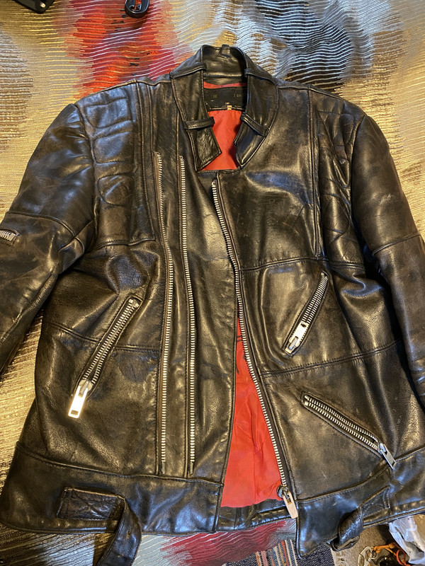

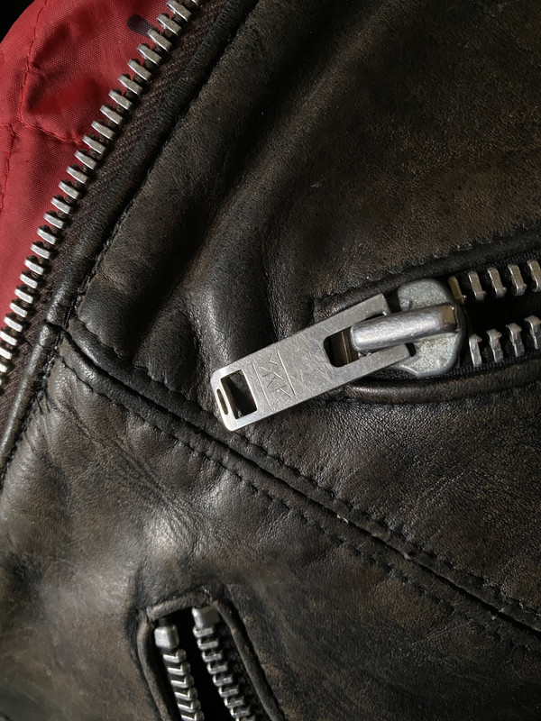

The only time I’ve ever managed to properly fix a broken zip was on an old leather bike jacket I bought secondhand from a shop in Bath. The original main zip had been replaced, and the pull tab wasn’t anywhere near as good as the original one, which was aluminium. Instead it was a cheap plated zinc, and eventually the ‘bar’ that went through the part of the zip that locks and unlocks just snapped.
I think I managed to get a thin bit of cord through in a loop with a knot on the end, but it didn’t really work very well, and I needed something a bit more substantial.
Here’s the jacket, which I’ve had since the early 80’s…
Here’s a close-up of the original zip…

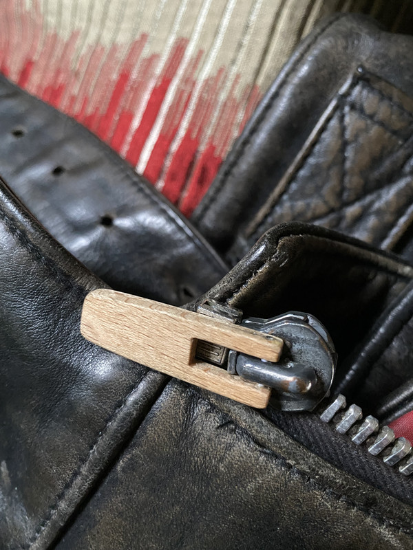

Here’s what I did as a replacement…
It’s basically two ice-lolly sticks glued together with a piece of a large diameter needle cut down and set in a groove in the wood. I’m very pleased with how it turned out, I tapered it slightly, it looked better than just rectangular. This jacket is quite important to me, enough to spend out on having the lining taken out to have broken stitching repaired that was holding the jacket together, then the lining put back and restitched where seams had also com apart, and all that because of what’s on the lining…
