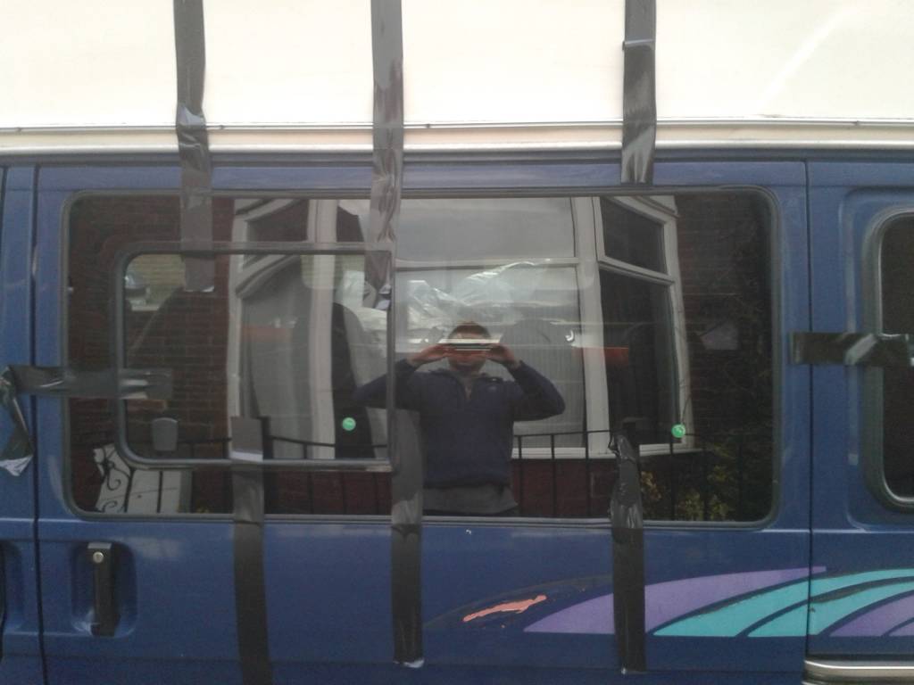

I did it on a T4. Cutting the hole with a jigsaw then gluing the outer to inner panel was the hardest bit.
I think the people I got the windows from has a how too video.
Clamped it with tape on the outside and sucker on window carriers from Screwfix tensioned(not too tight) to the other side with ratchet straps.
March 2015 the photo says. Sorry no pics of the inside.
