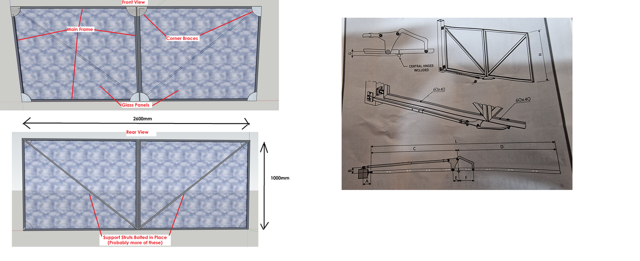

I want to put a metal gate across the driveway. This will replace to old rotten wooden gate that was there. There are big brick pillars to support it.
We want a bi-fold gate because it takes up a lot less of the drive when it is opened and means we will be able to open and close it with the cars on the drive. The old gate that just remained tied open because it was so long it meant we couldn't use the last 2.5m of driveway. The full and detailed instructions for the bi-fold mechanism are shown in the picture below along with my design idea.
I want to use some spare strengthened glass panels that will match the balustrade. These obviously need to be supported both sides and as I can't bend the glass to slide it in, It will need to be able to remove the supports from one side.
My basic idea is to get some reasonable size box section to make the main frame. Weld some support plates in the corners to keep it square and strong. The glass panels will rest on the main frame, pushed against the front support panels. On the back there will be bolt on support bars to stop the glass falling out. I have only put 2 of these on the diagram but am thinking I will probably add several vertical ones rather than the diagonals.
Will the gate sag?
What can I do to stop that?
Any better design suggestion where the main criteria is a gate where the maiun visual feature is the large glass panel?

Using the glass is going to add a lot of weight and it will be difficult to put diagonal bracing that won't interfere with the visual aspects of the glass.
Could you not use a laser cut mild steel decorative/patterned panel instead that could be welded in thus creating a strong but visually appealing design?
The laser cut design cut depict a headless squirrel......
If you insist on the glass could you put a wheel on the bottom of the middle gate hinge and have a curved steel track on the floor for it to run on whilst supporting the weight?

Will the glass itself not provide the diagonal bracing?
Posted : 12/07/2022 11:19 pm
those diagonal braces are the wrong way round?
well they are if it was wooden.
Posted : 12/07/2022 11:23 pm

The glass, in my design, is resting on the frame as there is no way to fix it firmly so it will provide little actual bracing.
Diagonals copied from the leaflet. Wood works best under compression whilst steel is better under tension perhaps?

I can see there will be a lot of weight on the hinge at the gate post but my question is more about whether the corner panels on one side of the frame will be enough to maintain square. Any way to estimate the load and the strength?

Thats my thought - the glass turns the gate into a sail - so you've got two  stresses on the gate pillars and the fixings that go into them - the weight bearing down and the wind load horizontally. They'd be pretty lively to handle , especially hinged in the middle, when opening / closing in any wind - thats something your visiting postman / milkman / jahova's witness is going to have to contend with so theres a bit of a liability issue.
However - the diagonal brace is pretty ugly if your balustrade you're matching in otherwise frameless. I'd use the glass as its intended and mount it in the frame using weld-on glass balustrade clamps. That way the glass is held away from the metalwork which is important as if theres any rattle or friction between the steel and the glass and an edge chips the whole sheet can just pop. The clamps have a softer hold in also isolate the glass and steel a bit to allow for any expansion/contraction.  But also being clamped in securely it becomes a stressed member and does the job of bracing the frame. It also makes replacing glass easy after an 'accident'. How many spares have you got? 🙂

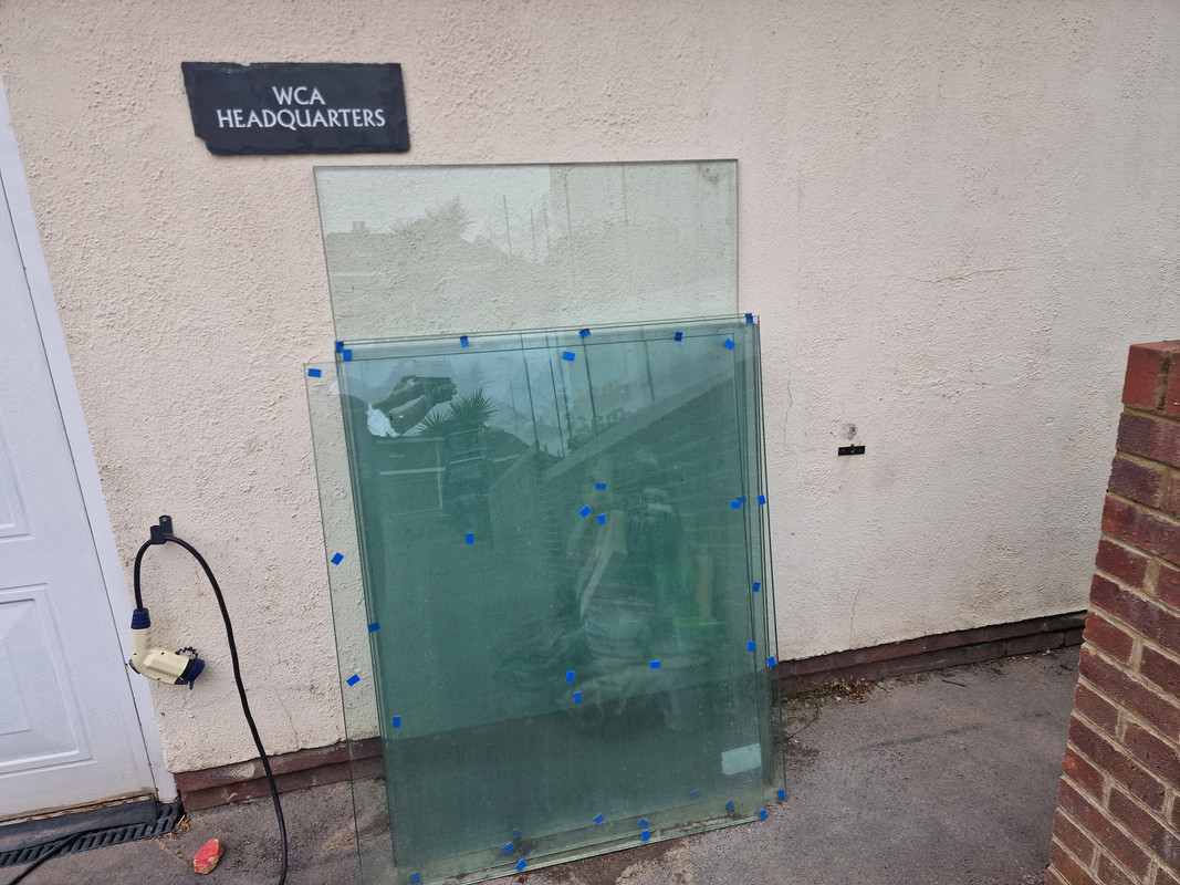

As a side note, part of the inspiration for using the glass panel is the pile of 6 spare glass panels leaning against the garage wall that I can't think what to do with and no-one seems to want.

His idea is sound. It will need diagonal bracing. The metal box section we use is 60mm x 60mm x 3mm thick, but that's for a pair of bi folding gates with an opening span of 6.5 meters. He will have to be careful of the brick pillars though. They will have to be strong.

Is that an EV charger coming out of the grate under the door??
love the sign btw 🙂

The diagonal bracing or 'support strut' as you have noted, is, as previously mentioned, the wrong way round.
Theres a potential for you to end up with some very very heavy, and not very strong gates if you get it wrong - I'd get yourself some CAD (sketchup!?) or some graph/lined paper and do some real thinking before you start chopping up random bits of box section.

Marginal saving in weight but possibly less visually unpleasant, could you use some stainless steel cables and turn buckles for diagonal bracing?IANAE

EV Charger - Yes. I have a crap 2011 Nissan Leaf with about a 30 mile range I use to get to and from the train station / shop as I can't walk and don't want to wreck the V8s with short journeys from cold, I mean because I am a die hard eco-bunny. Just plugged into a 3 pin mains socket and takes about 3-4 hours to fully charge because the battery capacity is so small.
Bracing direction - I just copied the picture in the leaflet but will check out other metal gates to see what is best practice. I think that the bracing for metal gates is reversed from wooden gates because wood works best as a brace under compression while the metal works best under tension but I will check.
