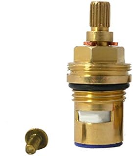

the bath tap is dripping and would like to change gasket on it and I dont know what/which gasket to buy....how do you disassemble this thing? I tried to pry out that thingy (odd looking washer) but it wont come out 😥

Spanner on the hex and undo.

Water off first, obviously! Spanner on hex part of tap under spindle, sometimes helps to tighten first to ease any corrosion then undo and replace washer. Silicone grease on all the threads when you reassemble. If i t continues to drip with a new washer, the tap may need seat resurfacing. Worry about that if it still drips.

Only so you don't embarrass ourself, ask the supplier for tap washers as opposed to gaskets. Also, when you say you want to pry out the odd looking thingy/washer. What exactly are you on about? Have you already unscrewed the brass cartridge from the tap body(Chrome bit)?
If you have a gravity fed system turning off the cold water main will not stop the hot water from running and if it's piped correctly, that should be the hot water tap you're working on... I dunno, you don't sound like you're the man for the job to be honest.

That's almost certainly a cartridge tap (1/4-1 turn to on?) - the small circlip on the top lets the spindle come out once you've removed it from the tap.
Very few have any form of washer in them - they work by turning a plastic/ceramic cartridge closing the throughway. There will be a sealing washer on the base but thats only to seal the cartridge to the inlet - not the waterway like old fashioned taps which take multiple turns.
Wickes do them on the shelf in 1/2", Toolstation do a 3/4" converter so you can use 1/2" replacements although hardly anyone has them that big unless its a continental manufacturer.
Just spin it out and pop to Wickes or screwfix - nowhere really is cheaper.
Have a look [url= http://www.plumbers-mate-sales.co.uk/replacement-brass-valve-ceramic-disc-cartridges-130-c.asp ]HERE[/url] to give you an idea.

And if you live in a hard water area, just take it apart and give it a wipe with some vinegar or lime scale remover, cilit bang etc. If the surfaces of the ceramic disks aren't perfectly smooth they don't seal, so any gritty limescale will cause a drip. So it's worth taking it apart and re assembling before you go off buying bits.

As per the comments above, if its a quarter turn tap its not got a washer. I took the insert into an independent plumbing place and he has a big box of them which he sorted through until he found a match. Fixed the leak, unfortunately the splines for the tap lever were slightly undersized so the lever would sometimes overshoot when the tap was used!

If anyone can tell which type of cartridge is in that tap body from the op's photo, you're a better plumber than me.
Posted : 23/08/2016 11:28 pm
Out of those three it's the first one as can clearlu be seen by
1. Length of shaft
2. Threads clearly visible below the wee circlip thing.
However i'd definitly be taking it out and down a plumbers merchant
