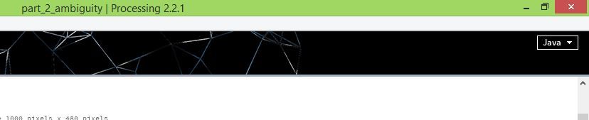

Posts: 12
One more question, that really will show my noviceness,
I'm using Processing 2.1 and it says Java at the top.
Is the code I'm using java language? At the moment, with my googling, I'm searching for, for example "processing create loop". Could I be looking for, "java create a loop and listen to us"?
Thanks
[img] ?t=1420973670[/img]
edit: thanks chambord. I wish I had someone teaching me.
