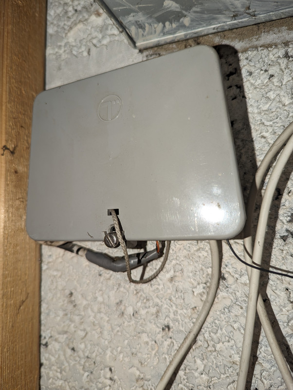

Having some buidling works done, and it turns out that what I thought was my master socket in the hallway isn't. Physically it is a master socket like this, with the two wires connected to the back plate and extensions in the house connected to the removable front plate, but it turns out that the wires on the back plate are not those from the outside drop wire (orange/white and green/black pairs), they are just extension cables (blue/blue stripe, orange/orange stripe, green/green stripe).

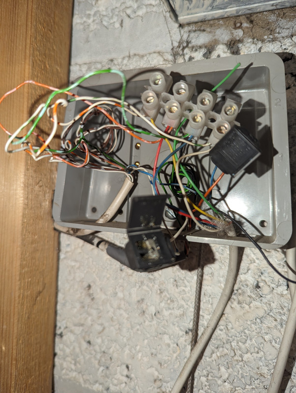

Having traced the BT wire from the pole, it comes into the house in what was once a garage (converted by the previous owners) and goes to a grey boxed marked with the old BT logo. Inside the box is the termination of the drop cable, which conects to two extension cables via the use of choc block connectors.
My question is can I/should I just install a master socket in place of this grey box? IS this a genuine BT connection from (approx 30) years ago when the works to convert the garage would have been done? Or has a previous owner cut the BT wires to the master socket and done this bodge. Do I need to pay BT to sort this, or should I just ignore it?
Our broadband has been pretty decent despite the wiring and the router not being connected to the master socket as I had thought, so maybe I should just ignore it all?
Grey box with drop cable entering left and 2 extension cables exiting right
You can see the main BT drop cable coming in from the bottom left.

Thats an original BT box with some DIY connections. Looks to me like you have the original BT cable connected through (striped) and an additional alarm cable (Red,Blue,Yellow).
Depending on where you want to move your master socket to and how far, I'd either disconnect the old cables and run in a new one with a new master box or if its all working fine leave it alone.

Would be suprised if thats not affecting your bb service.Grey box is called a bt66 we still use them, its a bit of a mess tbh, try getting an idea which the external orange/white are connected to, if they are going down a pair in the same internal cable that will be feeding your nte( master)
Yeah the external wires are connected orange/white to the blue/bluestripe that connects back to the (not) master socket as far as I can tell. The other external pair (green/black) are not connected. I have disconnected the extensions from the master socket, so may just disconnect the other wires here, as I dont think they are connected at the other end.

Or will they charge me as I suspect this was all done by the previous owner when they converted the garage - why would a phone line terminate in a garage otherwise, and why would there be a master socket in the hallway? I think they just cut the incoming wire and ran their own extension cable...
Posted : 13/09/2023 9:09 am
Posts: 1459
A good chance of getting a charge, as obviously it has been messed around with, depends on attending engineer.
As regard to master socket in hallway, lots of properties, have, throw back to pre BB days.
