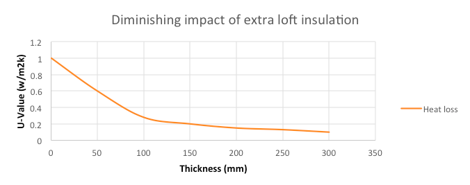

loftBear in mind diminishing returns. IE 200mm does not give twice as much reduction in heat loss as 100mm. Go past 270mm and there will be very little difference.
https://www.thegreenage.co.uk/what-is-the-recommended-thickness-of-loft-insulation/
