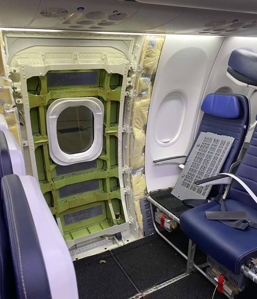

Nice pic of one of the plug doors undergoing inspection. Instead of a release mechanism it has static feet that rest against the airframe aperture. I don’t think the dome head screws actually screw into the airframe - they look like they’re there for adjustment with the locking performed by a false release mechanism. As in all pressurised aircraft doors* the lock actually prevents the door from opening into the cabin - air pressure generally holding it all shut while in flight. It should, in theory, be fail safe mechanically. I wonder if it’s fatigued?
IMG_8547
*infamous dc-10 excepted.

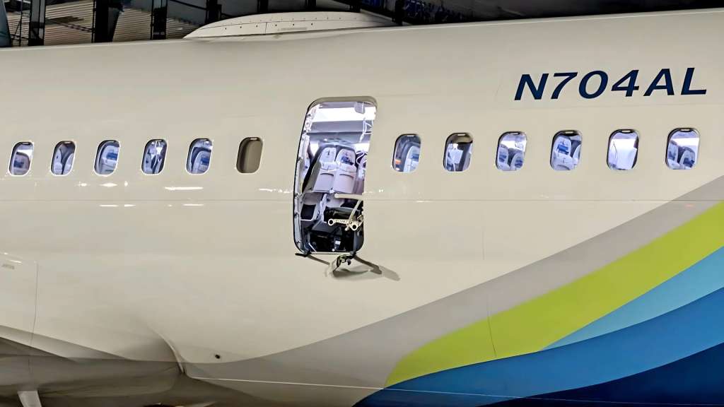

Posts: 4600
Shot of the outside. It looks like the aperture fixings are intact, but there appears to be some sort of hinge mechanism at the base which I assume used to belong to the door. At a guess, the thing failed right in the middle and folded itself in two?
Alaska-Airlines-737-9-737-MAX-9-blown-plugged-door-N704AL-outside

Posts: 11688
It wouldn't fail like that if the tabs were intact. For it to fold in the middle, the tabs would have to fail.
If the locating bolts weren't fitted, it could work loose as the airframe flexed until the tabs on the door and fuselage weren't aligned, then it would blow out. That would explain the previous incidents of loss of pressurization.

I was thinking the structure of the door itself failed. It's basically a series of 6 bridges that span the gap between the tabs. From the photo of the one under inspection one of those bridges is interrupted by the window and another takes a route around the window. If it were to bend in two vertically due to fatigue there's nothing to keep it in place in the top or bottom of the aperture - it'd just flow over the tabs and pop out. (The top is basically a movable draft seal and the bottom is where a slide would be mounted in the "real door" scenario).
Its not a flawed design, I can see why you'd do this as it gives leasors great flexibility for the future. Both boeing & airbus have used them for years (A321 iirc has them and I think some of the longer 757s and the 738/9s.)
