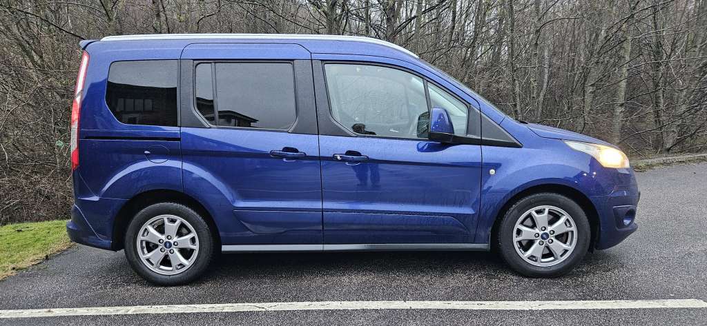

The wheels on my van are looking a bit tatty so it’s either have them painted or for an extra £25 per wheel powder coated. The guy who is going to paint them ( but hasn’t seen them yet ) says if they need shot blasting ( which he dosent do ) he knows another company who will do that then powder coat them as well.
Any preferences? Doing them black if that matters.
