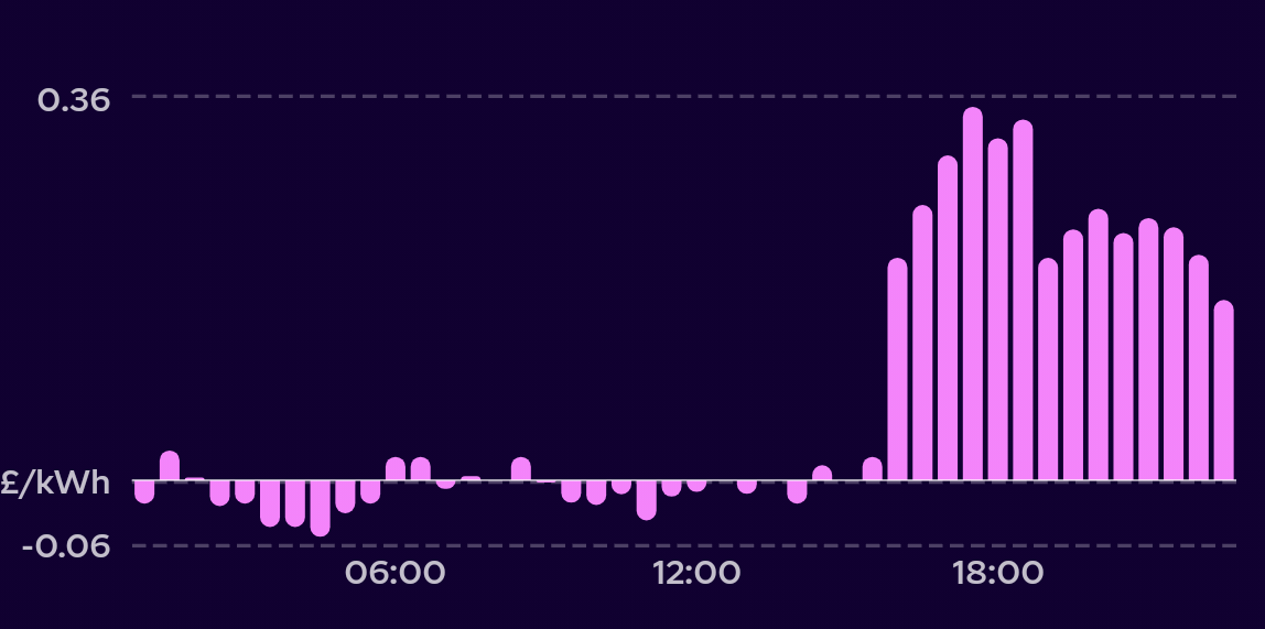

Posts: 2010
At last! Some negative pricing 😀 Screenshot_2025-03-29-15-54-48-511_energy.octopus.octopusenergy.android.png
Posted : 29/03/2025 3:57 pm

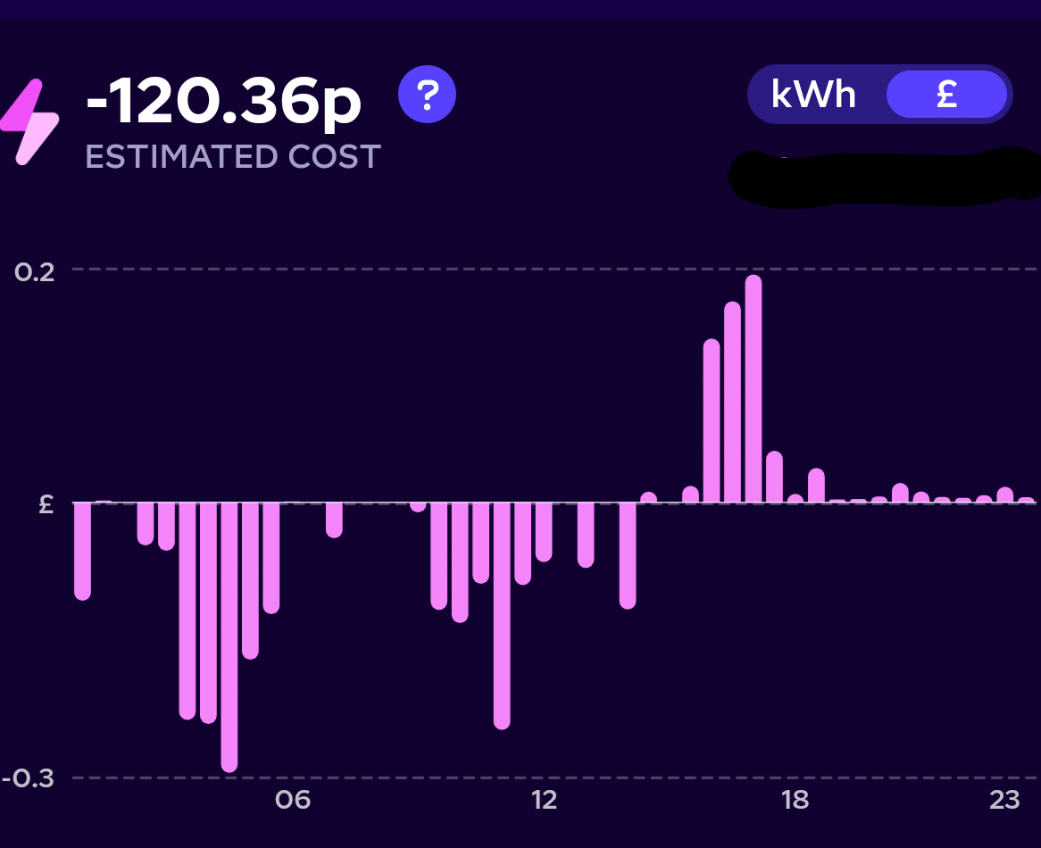

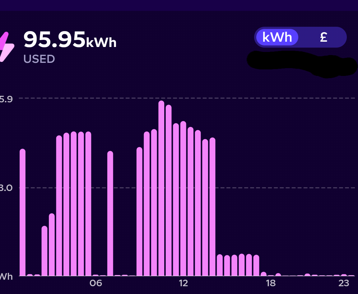

Posts: 2010
Editing....
Only a 55p error with the heater. Screenshot_2025-03-31-16-08-47-648_energy.octopus.octopusenergy.android_1.pngScreenshot_2025-03-31-16-09-05-933_energy.octopus.octopusenergy.android_1.png
Posted : 31/03/2025 3:19 pm
