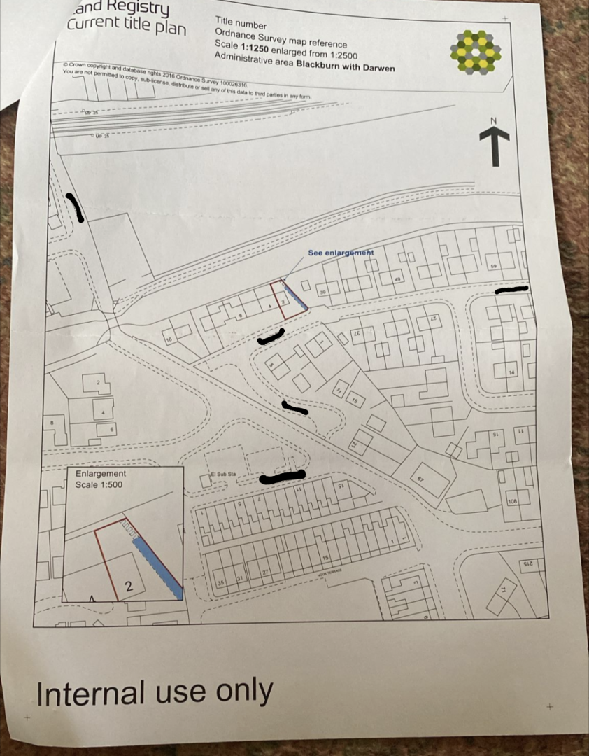

A boundary wall has fallen into the canal at my parents house.
I've contacted the canal trust who have said it's not their property.
Also tried to go through the house insurance and they have rejected the claim.
I've just found the land registry title plan when my parents bought the house and it clearly shows the canal wall isn't part of my parents property.
Does anyone know the best people to speak to about getting this fixed?

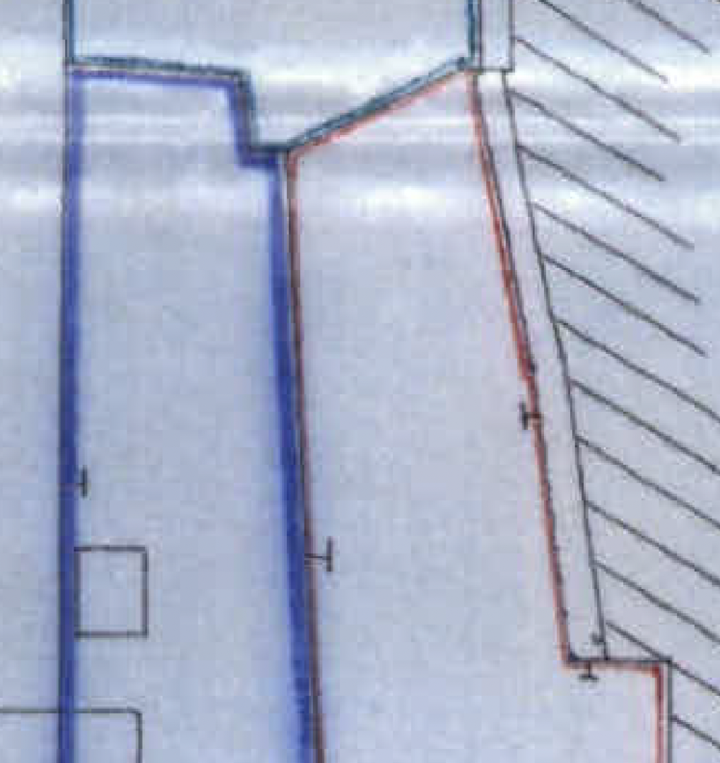

How does that plan show the wall isn't your parents responsibility?
That just shows the boundaries of the property (red line) not who is responsible for each one.
You may need to find an older plan that has little 'T's' to mark the responsibility. A T on your side of a boundary indicates it's your responsibility. This is mine (red border) - I'm responsible for all 3! Screenshot 2025-04-14 at 10.50.19.png ...
Also - if your parents boundary is the red line, and the canal is the blue section then it seems that bit of the canal belongs to them!

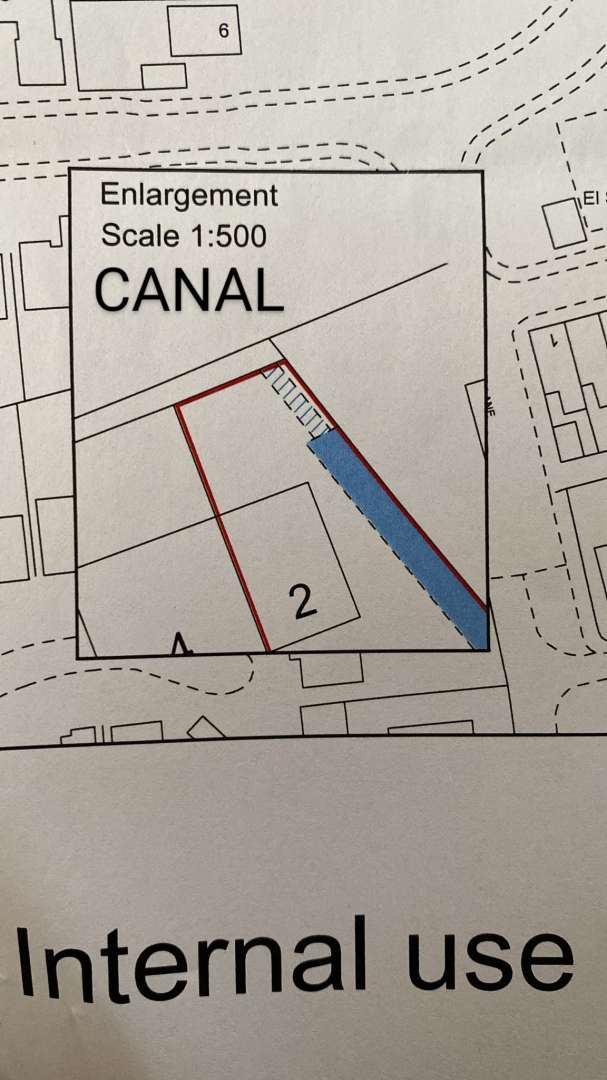

Posts: 3955
Posted by: the-muffin-man
The blue bit had me confused, but I think the boundary in question is the northern one in that plan.

Posts: 12178
I am currently on the fence*, that plan doesn't really tell you anything other than the blue bit (canal**) and the slightly narrower line hatched (culvert at a guess?) is within the red boundary.
But it doesn't tell you anything about the boundary and who owns what.
*Ownership... Unclear.
** Unique boatique(TM) air bnb potential right there.
Your parents can have that TM on me.
Posted : 14/04/2025 11:22 am

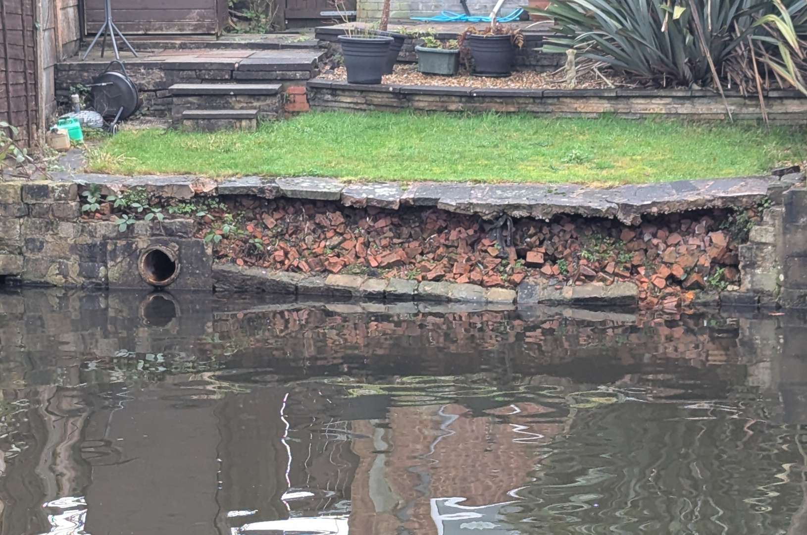

Posts: 11658
See the post right above yours joshvegas, I think you've misinterpreted the drawing, as did I with no explanation. Looks like the boundary might actually be the wall with the gravel and pots on it in the photo. Which is also subsiding by the looks of it, is the ground under the grass heavily waterlogged?
Posted : 14/04/2025 11:31 am
Posts: 907
I wonder if that blue bit on the plan is actually a clue as to the cause? I assume the canal is E-W across the Northern part of the diagram? In the picture, there is a round outlet in the wall, which looks to be where the zig zag is on the diagram, which then runs into the blue strip. Is there a stream or something running under the garden to the canal? Perhaps something has failed there causing that water to travel under the garden, causing this damage, instead of through the outlet into the canal?

Posts: 16326
I read it as the northern boundary. The canal is the top of the box, then there is a little access area running along all the back gardens, then the OP's property. It also looks they are the last property. Round here there are loads of properties like that and the last property just takes that bit as their own. If it's not owned by the canal then whoever does own is unable to use it. In the OPs case I'd say that is potentially a headache as this problems becomes their problem but having your own waterfront must add a chunk of value.
Posted : 14/04/2025 11:48 am
Posts: 16326
Posted by: imnotamused
That's a good point. Whoever maintains that may be responsible. Might be the water authority. If its classed as a shared drain then it will be in public ownership and up to them to maintain. They came and dug our patio up and fixed an underground pipe and made good at no cost. Not sure what happens if it is just a culverted river.
Posted : 14/04/2025 11:59 am
Posts: 4156
I wouldn't call that a boundary wall. It's the canal bank. Assuming the canal is at the top of the plan and the boundary is where the pots are, there's no boundary wall. If they've told C&RT it's a boundary wall I'm not surprised they've said it's not theirs.
It would be worth some general Googling as to the ownership of canal banks.
The idea of taking possession does sound worth considering, but it might involve doing the repair.
Posted : 14/04/2025 12:00 pm

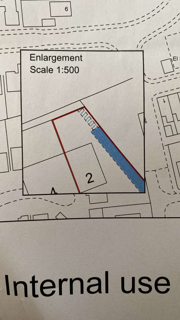

Posts: 12178
Ah okay yep
Solid blue shared access. Blue lined hatch... Rights over private garden to the canal.
The plan still doesn't show ownership though. The redline within the blackline shows that the ownership is up to the blackline the ownership of blackline is still unclear. I mean its seems a stretch that it isn't a canal wall. But historically if its a dead end, is it a dock off the canal? And in which case it might be the ownership relates to the historic use of the land ie private wharf . Which would kind of make sense if the properties all have a lega right to access it.
Either way, where do you keep your paddlebboard?
Posted : 14/04/2025 12:12 pm

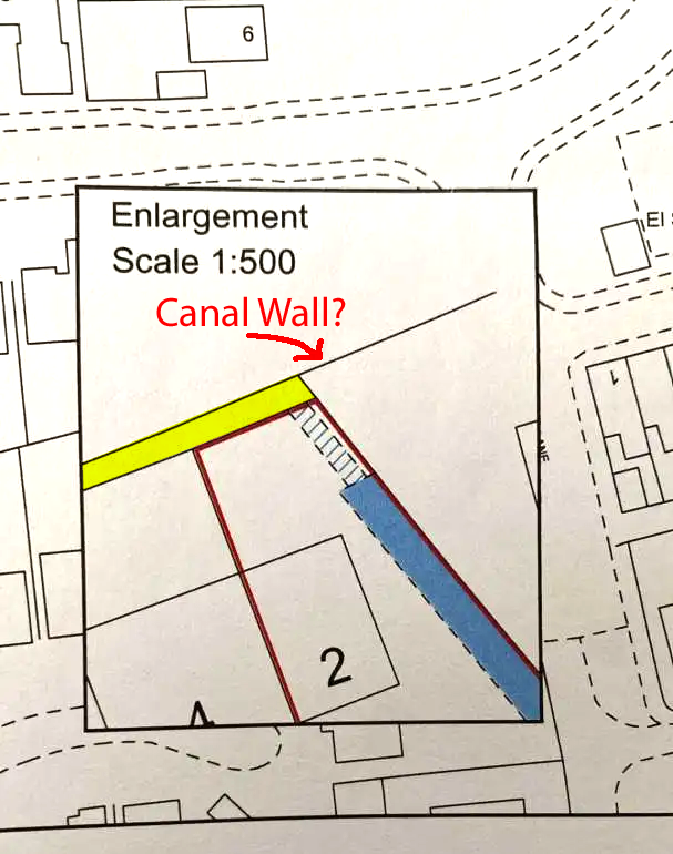

Posts: 1180
Thanks all for the replies so far. I should have marked the canal on the drawing.
The insurance has refused as they say it's wear and tear. Ideally I would like to find who is responsible as my mum has dementia and we've spent a lot of her savings the last two years on carers going in to help her.
I'll go to the land registry and contact the council see if they will help.
I've marked the canal on the image below. No idea what the blue is. I'm presuming it's a drain as in the photo there is a pipe to the lh side.

Posts: 13388
Who owns the bit marked in yellow below? That plan seems to suggest there's a metre or two of unclaimed land which I'd guess the collapsed wall sits within that couple of metres? That certainly doesn't belong to your parents.
You may need to do some digging with land registry as sometimes you get these little pockets of land that are owned by no-one.
Looking further along the area map it may well have been an old towpath as it continues (with a break) to the east.
Posted : 14/04/2025 3:55 pm
Posts: 1180
That's what I'm trying to find out. The part you've highlighted yellow is the canal wall. My first point of contact was the canal trust as I thought they were responsible for the wall but they're saying they aren't.
Posted : 14/04/2025 4:49 pm
