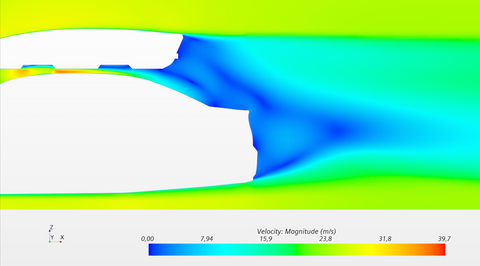

If you've got a towball you can get a 'roofbox' that goes on there instead behind the car. Called an Ixtabox.
https://ixtabox.com/pages/ixtabox-vs-roofbox-1
Comically expensive but maybe somebody else makes a cheaper clone of it

Posts: 1886
marcus
rsl – So a long thin box (small frontage) which overhangs the front of the roof will create less drag (better efficiency) than a wider box set further back ? Makes sense that the air flow from the bonnet and windscreen would pass under the box. Broadly speaking.
If you look on the aerodynamics tab on that Ixta page i linked above, there is a pic showing why this is the case. Basically the roofbox creates a large low pressure area behind it.
edit- the image (courtesy of the Ixta site)
Being further forward i don't think makes much difference, but being wider makes this low pressure region larger.
Certainly my full width box seems worse than the half width one.

If anyone else is interested. https://pureportal.coventry.ac.uk/en/studentTheses/aerodynamic-designing-and-position-optimization-of-roof-box
