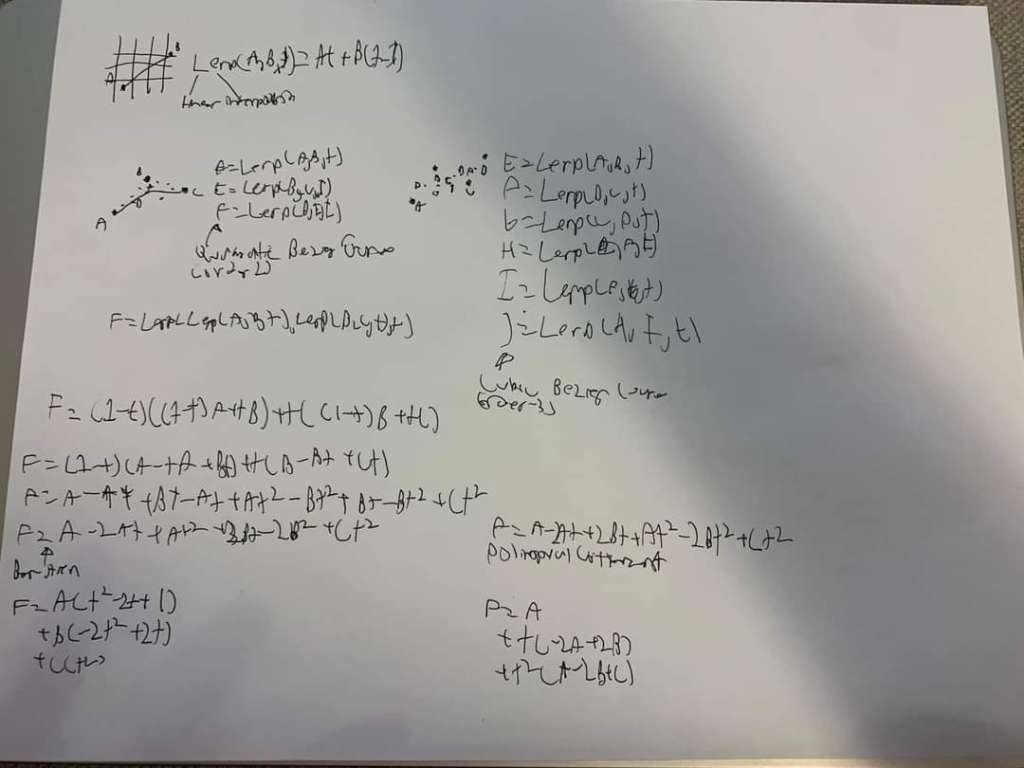

I'm told this is the maths for a bezier curve. Can anyone confirm whether it is, or it's just gibberish?
FB_IMG_1698713600817
I'll explain why I'm asking later.

I asked MS Bing AI chat, it said yes, no idea if it's correct or just more gibberish. Unfortunately, I keep getting an error when I try to post what the AI said.

IDK but I did find this sort of interesting JavaScript babble https://javascript.info/bezier-curve

Yes that looks like the maths for a linear bezier curve (i.e straight line in the top left), quadratic bezier below that on the left and cubic to the right of that. Whether it’s correct or not is lost in the mists of my past and the slightly challenging handwriting.
This might be useful; bezier splines from linear interpolations: https://github.com/hubertben/Bezier-Spline-From-Lerp#

Ah, I've got a fuller explanation from a friend elsewhere which correlates with and expands on what jonwe said. It is, we believe now, correct.
The reason I ask, the question was posed by a friend of mine. The author is her son. Her son is 12.
(His teachers are obsessed with his shitty handwriting.)

I was going to say, with handwriting like that, it's gotta be someone with a PHD, so it's probably correct 😉  😀
