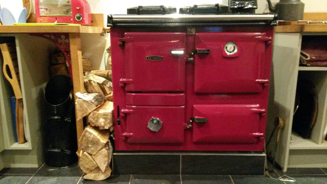

Posts: 2295
In our previous house we had a solid fuel Rayburn for hot water, heating and the sole means of cooking. The previous owner had installed this system.
The whole set up was a complete PITA.
Anyhow, there was an "always on" radiator in the hall way. So, when trying to cook a chicken mid summer with the kitchen approaching the temperature of the sun the radiator would come on to remove some of the excess heat from the water tank and stop the whole system boiling over.
I am so glad we moved.
Edit - Here it is, the evil red monster:
Posted : 23/08/2021 11:07 am
