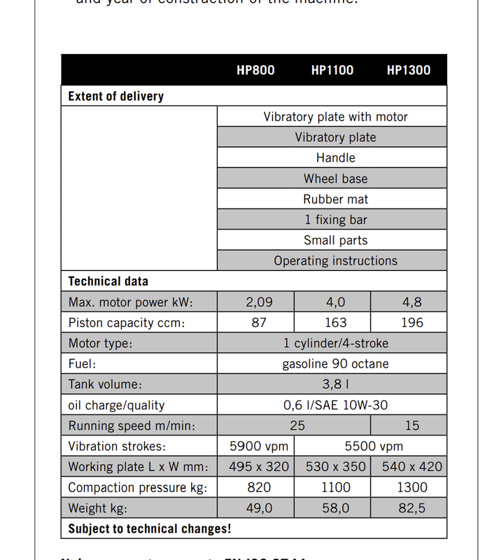

Posts: 6071
Check the spec plates on the machine, the images from your link show HP1100S. Manual here https://www.manualslib.com/manual/2071108/Scheppach-Hp1100s.html?page=21#manual
Recommended octane rating over 90 unleaded gasoline For unleaded gasoline, can make carbon deposit muck less and enhance exhaust system service life
Recommended engine oil SAE 10W-30 or 10W-40 (depending on the operating temperature)
You can safely use E5 petrol in an E10 engine ^^ , some garden machinery prefers E5. Drain the petrol if you're not using it for a few weeks and run until it cuts out

Posts: 57
I did a Google search for "Instruction manual for scheppach-hp110s-petrol-compactor".  The manufacturer doesn't have manuals on their website  https://www.scheppach.com/en/service/contact-forms but you can at least contact them if you lose yours.  I found what I think you have on a dodgy-looking website (ManualsLib).
Page 3 has drawings with things numbered, the English language part of the manual starts at page 22.
Page 26 section 10 includes instructions for checking the engine oil.
Page 22 section 2 "Device description"(figure A)" does not seem to include the engine oil dipstick, so I'm afraid that you are on your own to find something that looks like a dipstick.
Page 22 section 3 "Technical data" gives the motoroil volume as max 0,6 litre, which I think is German for 0.6 litres, or 600 millilitres.
Page 29 gives instructions for changing the motor oil - you could use the refilling part of the changing instructions for the first fill.  Doesn't specifically explain where to put the oil, but it does refer to "the filling cap (measuring stick)", so it might be a case of using a funnel to pour it down the dipstick tube, which would be awkward, but for 600ml, shouldn't be the end of the world.  I'm afraid that I couldn't find a diagram of this part of the engine.
Yes, I know the manual has referred to it as "engine oil", "motoroil" and "motor oil".  I think that they all refer to the same thing, and that they are the result of a less-than-perfect translation.
Recommended engine oil is SAE 10W-30 or 10W-40 (depending on the operating temperature).  If you are out buying engine oil, something like Halfords own should do fine.
If you want to be more picky about engine oil, check https://www.opieoils.co.uk/t-api-car-engine-oil-specifications-explained.aspx or https://www.valvolineglobal.com/en-eur/understanding-oil-standards-acea-specifications/ There is a bewildering selection of higher specification that car manufacturers require because car engines are now very advanced.  If I'm reading those websites correctly, might be sensible to look for something like:
  • API (stands for American Petroleum Institute) 'S' specification of 'L' or later:  will say something like "API SM"
  • and/or ACEA (stands for European automobile manufacturers association, but in French "Association des Constructeurs Européens d'Automobiles"), grade A/B, probably A3/B3.
Oh, and Page 28, section 13 "Storage" gives instructions for draining the fuel tank completely, starting the engine, and running it until it stops.  DON'T BE LAZY.
You mentioned that you don't know much about this sort of thing, so with apologies, and at the risk of insulting your intelligence, I will write this:  Do drain the petrol and run the engine.  DO NOT DRAIN THE ENGINE OIL AND RUN THE ENGINE!  Would be a very quick way of making an expensive, useless garden ornament.
