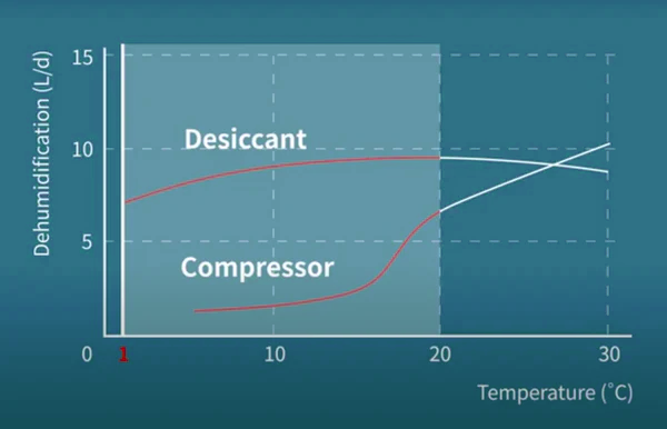

According to this (note this is speed not power efficiency- but it tells you the compressor would need to run longer to achieve the same extraction so it kinda is):
(src https://ionmax.com.au/blogs/resources/desiccant-or-compressor-dehumidifier)
It looks like desiccant would be a better option.
I have a compressor powered one and can confirm it is noticeably slower at 15-17 than at 21.
