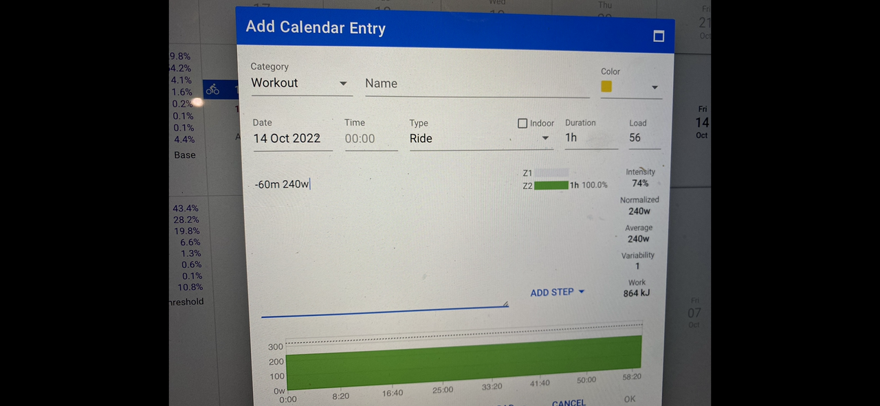

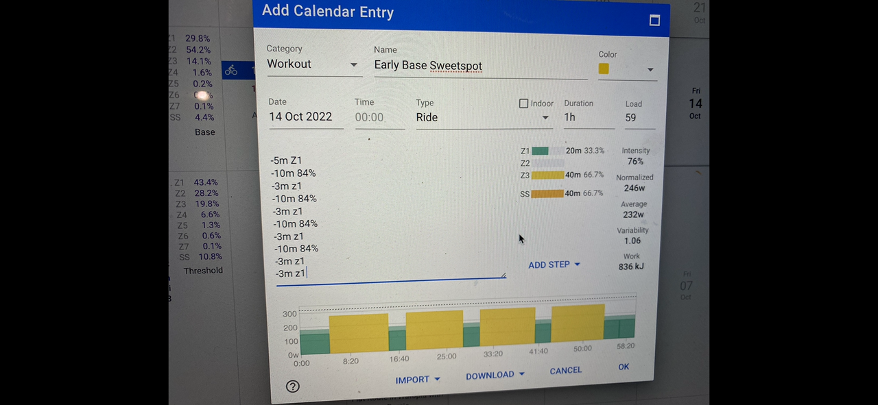

Posts: 4398
Interesting thread. Mostly agreeing with my thoughts about Zwift plans 🤣 But I’ve also gone ‘beyond’ TR now too in my thinking.
Especially with the latest (or rather rehashed/better explained) Z2 ideas coming out around Inego San Milan lately.
Eg:
So if I was recommending someone how to best use Zwift to train- I would probably say do one Zwift race a week, ideally around an hour rather than a short one.
And the rest of the time do group rides and pace partner rides that keep you right at the ‘talk test’ intensity for as long as you can possibly stand being on the trainer.
As per here:
If that’s three sessions per week (one race and two ‘talk test’ endurance rides) I’d say use any extra sessions you can fit in as ‘easy’ endurance free rides by ticking off the routes as a challenge.
Posted : 10/11/2022 10:26 am
I don't like that at all... but i do get it.
How long are we talking about ? 90 mins? 120 ? more ?
I'd guess for me it's about 170w.... But i'll give it a try. Maybe even later today as it's still wet.

Posts: 4398
@Weeksy- 45mins minimum but 30 mins 5 times a week would be better than 1x 2h30. Frequency first, then duration.
Z2 (as per the ISM method) is not easy or dawdling. If it is you are doing it wrong.
For most people it will end up as Z2 HR and Z3 watts.
It’s also not true that you do more work at sweetspot. Let’s say you have an hour. With the Z2 method you can jump on and start pedalling at target power and just stop when your done. No pressing need to warm up or cool down. The interval becomes 1x60 at say, 76-78% ftp.
With a 4x10 sweetspot workout with 5 min Z1 recoveries and a brief warm up and cool down (necessary to clear the extra lactate higher intensity produces), you will discover the *average* for the session will not be much over the same percentage of your ftp. Kj’s burned will be pretty close.
Also- if you listen to ISM, the intention with his style of Z2 is to maximally exercise your slow twitch fibres.
For a fast twitch carb monster like me- this makes proper Z2 actually really challenging. My body begs to go a little bit harder so the fast twitch dudes start helping out.
To bastardise his analogy, it’s like reviving the tits off your car in gear 2 and refusing to let the engine have gear 3 so it can relax a bit 🤣
Also, because you don’t stress the autonomic nervous system as much, there very little if any residual fatigue! What I’ve found over the past few weeks is that instead of getting more tired from ride to ride and then craving a rest week- I’m actually addicted to it and want to ride more and more!
Early October, really pushing that talk test limit for 2h30 had me at 225w. On Sunday, I did a Zwift group ride at the same HR/intensity and averaged 244w!!
Think about how useful that is for your general cycling if when you’re just riding about at your normal pace- you’re +20w faster.
Increase your FTP for vanity, your Aerobic threshold for sanity 🙂

Posts: 4398
Slightly contrived to make it easy to create but illustrates the point that a session of Z2 isn’t just effective for people with hours to spare. (And that example is probably a bit low for ISM type Z2 but I wanted it to stay green for illustration purposes 😉 )
Posted : 10/11/2022 1:09 pm
