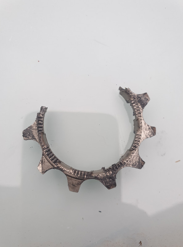

cog
This is the 11t cog from my 11-46 ZTTO 11 speed cassette. Put it on in October, last year. Seemed OK to begin with. A couple of weeks later, on a ride to work, on a flat bit of road, I changed up a gear. A horrible noise ensued, which I thought was an alignment issue, as I had issues when riding in the lowest gear. When I got home to assess what I needed to do, I found that! Happily had an old XT cassette so popped the 11t cog from that on.

I've had refunds from an item arriving that was utterly and completely different to the label (a baby bed thing instead of brake pads???) I think they put the wrong label on the packet. Communication was excellent though.
I've bought a few small cogs on ali to extend the life of my 11sp cassettes - my commuting bike uses up the small cogs fast - and although they don't last long they are only a couple of quid. I've had one crack but nothing as bonkers as the photo above.
