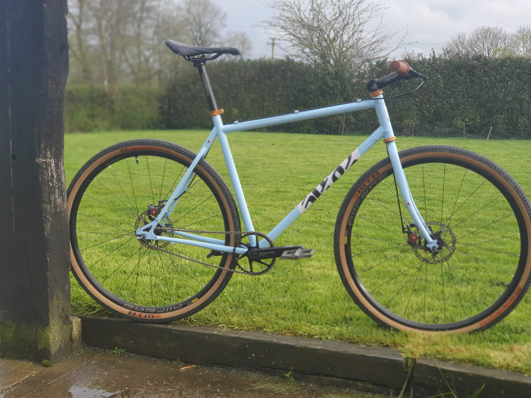

So far so good TBH. Resprayed a steel road bike two years ago - took a fair while with prep, but as it was a metallic pearlescent white it took a good deal of primer that had to be perfect for the pearlescent to show well as it's near translucent. Still looks great, but the paint took quite a while to harden.
Also resprayed my old MTB in December - that's my daily commuter, but I used a gunmetal colour spray paint that didn't need all the prep. This resulted in a thinner coat that's dried well. Also, if I do scratch it up, it's no big deal to repaint a whole tube.
Halfords rattle tins - the white bike was quite expensive to do, the 'grey' one much less so.
