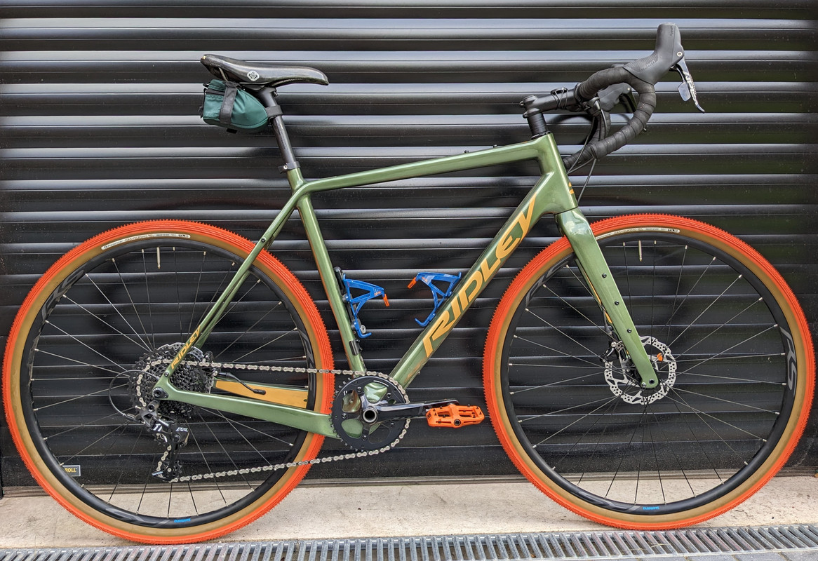

Thank you all, I've gone and ordered the GravelKing SK 43mm in orange with brown sidewalls, a pair of Raceface Chester pedals in orange and orange highlighted bottle cages to complete the look. I'd have felt a bit daft buying another version of the same tyre, it's not logical but, well I've just bought orange kit so where does logic come in. If I change the bars you know there will be orange tape going on there too.

The future's bright...
