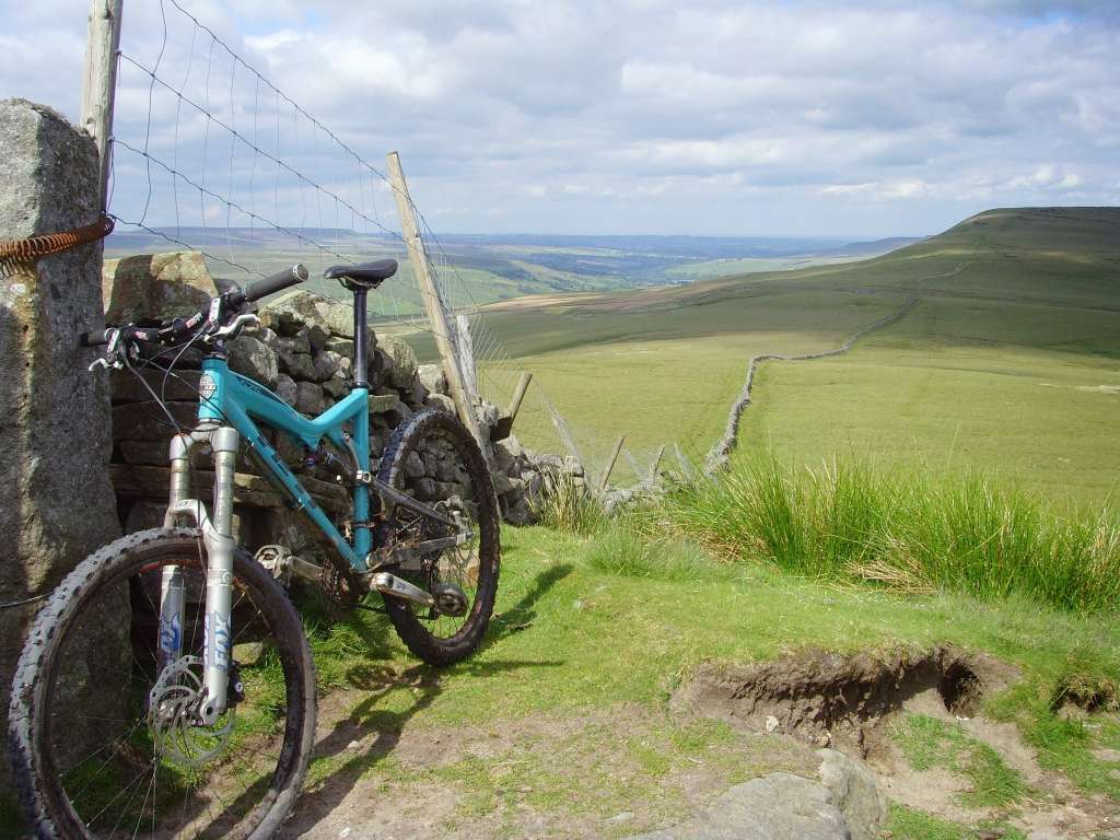

Question is, how feasible to go 1x?
Very, Here' my ARS-C which is probs about the same vintage
Yeti ASR-C
Would a 1×11 cassette fit on the wheels?
Yes if you've got regular Shimano HG, there's any number of cassette options
Chainline; would that work?
Yes, you'll want about 48-49mm. which should be pretty standard for your bike
Posted : 08/09/2023 11:56 am

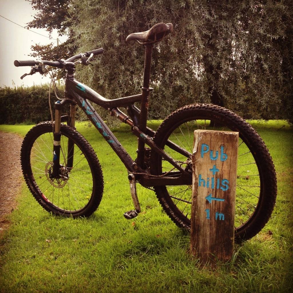

Not the 575 but my old 5 alloy. It's such a shame that Yeti stopped doing alloy frames as they were absolute masters at them. It's still my favourite bike I've had. It was dug out the attic and rebuilt for my son.
It was stolen not long after this photo was taken (however due to 'new or old' I got £6k for it..)
IMG_0162
Posted : 09/09/2023 8:14 am

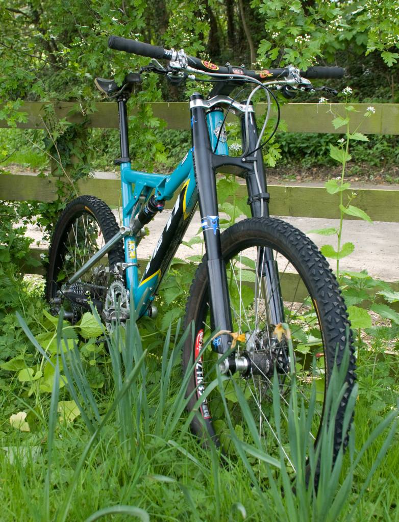

I'll join the Yeti love-in. My 2011 (?) ASR-5. It was a great bike at the time, and in my mind the last time I could afford a truly top-spec bike before the bike industry went crazy with top-end bike prices. It didn't want for anything really, XTR groupset (M970), Thompson / Easton / Reverb (back when they were rare-ish) / posh Revelations.
[url= https://i.postimg.cc/ZW2Wk4Vj/IMG-6232.pn g" target="_blank">https://i.postimg.cc/ZW2Wk4Vj/IMG-6232.pn g"/> [/img][/url]
[url= https://i.postimg.cc/WDZhTCyV/IMGP0035.pn g" target="_blank">https://i.postimg.cc/WDZhTCyV/IMGP0035.pn g"/> [/img][/url]
[url= https://i.postimg.cc/qt6p2Kcx/IMG-0648.pn g" target="_blank">https://i.postimg.cc/qt6p2Kcx/IMG-0648.pn g"/> [/img][/url]
Good times. It even made it onto the Mail online front page headline in one of their OMG Snow-maggeddon pictures which is quite a claim to fame!
Buuuut, I'm more than happy remembering the good times and leaving that bike in the past. Lovely as it was for the time, if I rode it again now I'm quite confident I'd be disappointed vs a modern bike.
Posted : 09/09/2023 12:29 pm

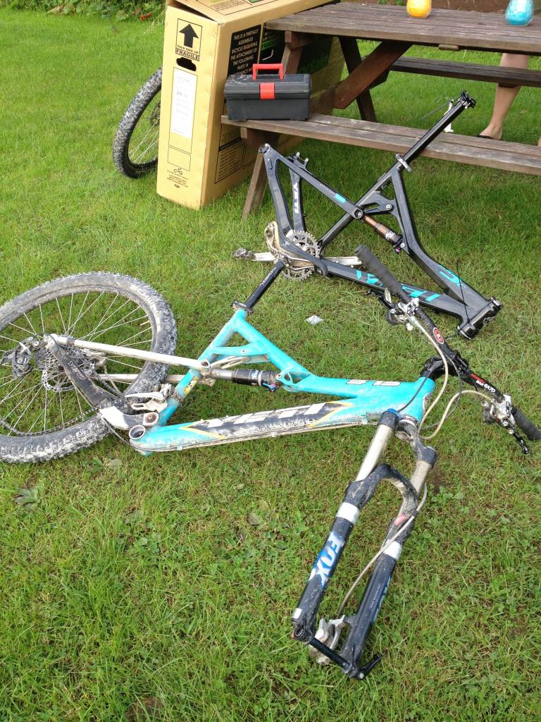

I loved my 575. Had it over six years, the swingarm cracked twice, one warranty, one third party repair before the carbon parted company with the alloy bearing housing for the main pivot. That final episode happened on holiday (day 3 I think…..) and I bought an ASR5C frame as a replacement. Had the headset installed by the shop and rebuilt the rest in the campsite 🏕️ whilst @ahsat cooked curry for tea and supplied me with beer. The 5c was a much better bike for me, it was lighter, taughter, stiffer, then I killed it on honeymoon coming down Helvellyn. I hit an iceberg of a rock with the downtube, it remained intact but creaked 😢
7991875710_654d7645a9_o7991883202_8c11f920e6_o
Posted : 09/09/2023 1:58 pm

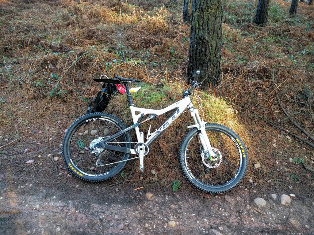

Nearly there! Just some fettling to do!
20240202_151600
Posted : 02/02/2024 10:27 pm

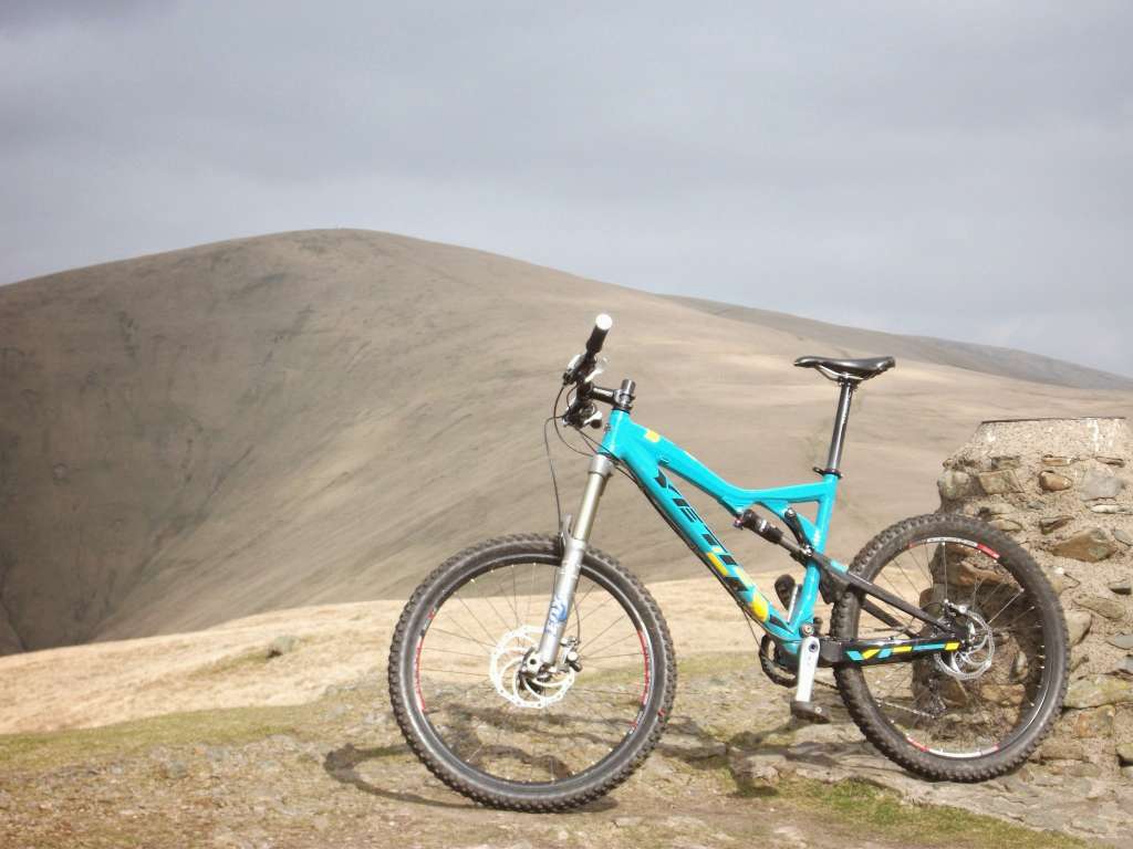

I had 2, broke the first one a few times sold the second because I had had enough of the bearing going. Still mt favourite bike and happiest time riding.
Picture 163
DSCF0763
Posted : 03/02/2024 8:36 am
