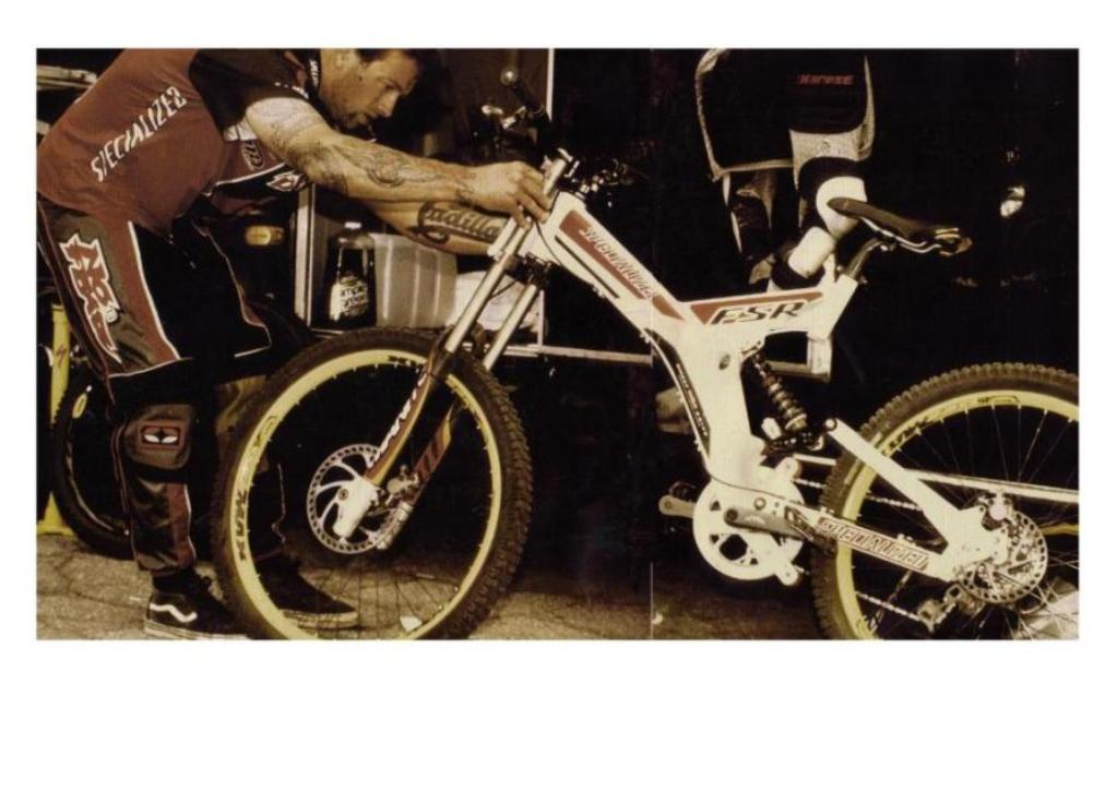

iirc many pro downhillers on Super 8, intense m1, gt dhi era bikes used to use square taper xtr when I started paying attention to that sort of thing. But perhaps they broke them and replaced them a lot?
eg:
I have original shape 170mm ht2 xt on mine and 3 years in, so far so good.

In regards to the "they used to use square taper cranks - perhaps they broke them and replaced them a lot?"
Middleburn RS7 - 'nuff said.
Posted : 04/03/2013 2:39 pm
@julianwilson. That Specialized does NOT have a Square taper chainset.. It's Octalink V1.

@gmez619, blimey, i'd forgotten there were even 2 octalink 'standards' 😳
Still, the point stands about people fitting undoubtedly lightweight cranks on 7" travel world cup dh bikes, and I wonder how many not-ht2 xtr cranks palmer etc munched their way through. (actually given the money in DH in those days, perhaps that is exactly what they did in the pursuit of half a second here and there?)
