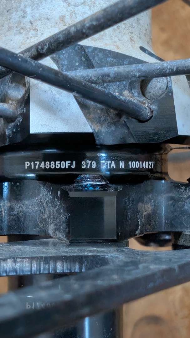

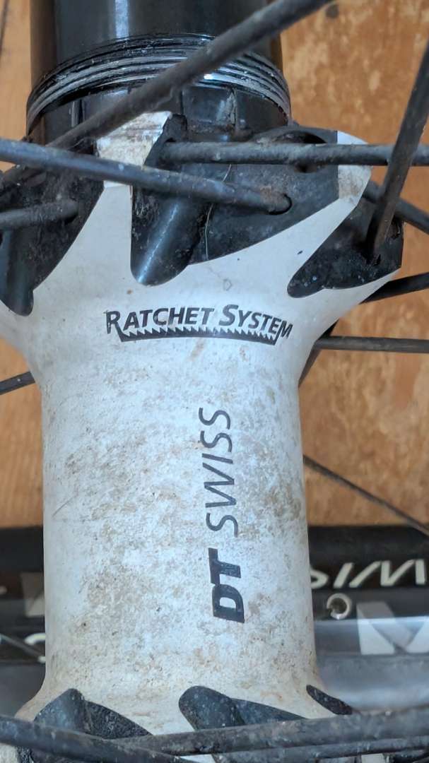

So, the wheels have arrived - have included photo of the hub and code numbers printed behind the disc mount. Any idea what freehub I need (HG)

 PJay
Posts: 4818
It doesn't mean anything to me but Madison are a DT Swiss Service Centre & have always got back to me when I've had questions. I'm pretty sure that they'd be able to help.

Posts: 383
Does it say anything on the freehub body? usually says Ratchet , Ratchet EXP or Ratchet LN on it.
