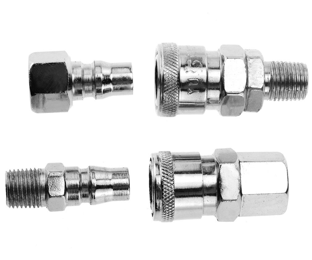

EBay for PCL 1/4" quick release fittings
Posted : 25/06/2017 4:13 pm

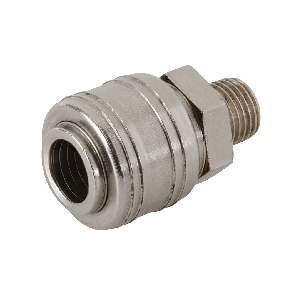

I'm guessing I need something like this?
https://www.amazon.co.uk/Silverline-237552-Thread-Coupler-4-inch/dp/B00IEIQ4B4/ref=pd_sim_60_7?_encoding=UTF8&psc=1&refRID=F2HX8QN51A2X99WDMK49
Posted : 25/06/2017 7:00 pm
Looks like the inlets have quick release fittings, but I removed them to fit the threaded ones that came with the hose. I've ordered this thing here:
Hopefully it will do the job! Thanks everybody for helping.
