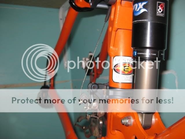

If the mech's the same as the one in the link then you should be fine. I'm running the same style although XTR 😉 and it works perfectly.
The cable does run at an angle from the mech stop on the seat tube to the pinch bolt on the front mech, but it should do, and it shouldn't have any real slack in it when in the granny ring. I'll post a pic of mine in a mo.

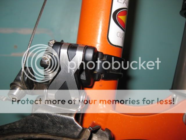

I've taken a look at this:
It shows the cable exiting outwards from the pinch bolt.
Mine exits inwards.
This might be enough to change the ratio of angle of shaft per pull distance on the cable.
Posted : 23/10/2010 10:20 pm
Here's my theory, and I'm about to go and try it.
Compare photo of actual with instruction diagram.
[url= http://farm5.static.flickr.com/4127/5108246741_fdd31ff421.jp g" target="_blank">http://farm5.static.flickr.com/4127/5108246741_fdd31ff421.jp g"/> [/img][/url]
[url= http://www.flickr.com/photos/92961862@N00/5108246741/ ]Derailleur_Close_Up_2[/url] by [url= http://www.flickr.com/people/92961862@N00/ ]tomstickland[/url], on Flickr
Posted : 23/10/2010 10:26 pm
Fixed it yet?
Posted : 23/10/2010 10:30 pm
Here's how it should be routed 😀
Posted : 23/10/2010 10:56 pm
Fixed it! Basically, following the instructions made it work.
Posted : 23/10/2010 11:17 pm
