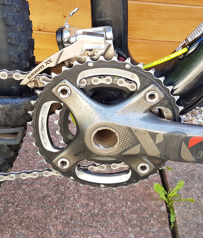

Just sold a bike on ebay, the buyer admits to not knowing much about bikes, so put it into his LBS to assemble it after shipping.
He's just been in touch to say the salesmen who booked it in says the rear cassette and chainrings need replacing. Nothings that old and everything was working fine when sold. Looking at these pics do they look worn out and need replacing ? Especially as nothing was slipping and the gears changed like clockwork.

Is the buyer asking for money back? It's not unheard of for a lbs to try and make more money out of a niave individual.
Posted : 19/09/2018 6:15 pm
Only the chain can need replacing if everything's working - once the chain gets too worn, fine, you're going to have to do everything else, but you wait until it stops working prior to that.
Used bike, unless you said it has a brand new chain on and it doesn't, then it sounds like someone at it (customer or LBS), misinterpreting or being OTT.

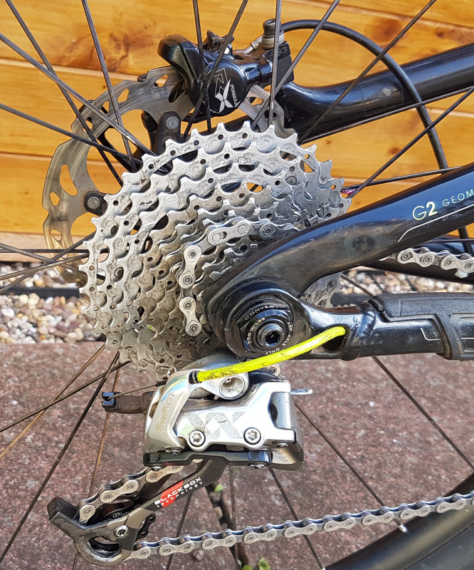

That said, can't see the condition of the cassette from the pic and there is some wear evident on the rings. The chain doesn't look totally shagged though, so your description sounds about right, perfectly rideable but not new.

Chainrings look ok but a pic tells nothing re chain and cassette.
Either buyer or chop could be trying it on.
Posted : 19/09/2018 6:20 pm
to me that chainri8ng is badly worn suggesting a worn drivetrain  but its a second hand bike, it was working fine and these are wear parts. If you sold it with the gears jumping all over the place it would be different so IMO you are in the right.

Yes .. and yes. That chain looks well stretched .. and that cassette got worse teeth than the Rocket.
Not to mention the front mech cable looking as if it gonna start to fray ... and you got weeds in your paving slabs.

The cassette and chainrings looked used,  nothing outrageous.
This screams of lbs trying to milk naive bike buyer for a load of new drivetrain parts.

My approach to chain, cassette and chainring wear in my workshop is to start with the chain. If the new chain skips on the cassette then it's new cassette time and likewise for chainrings. I never automatically change everything unless it's clearly been ridden to destruction.
Other bike shops may not take this approach and to save any hassle or comeback will just change the lot regardless, that way there is no way anything will skip.

Most likely only needs a chain and cassette.  Change the chain, and if it skips, new cassette.  Just got away with mine, chain snapped, but chain checker said 0.75, new chain and no skipping. Go to 1.0 on a checker and its likely a new cassette.
Chain rings are well used but look OK. 2x is a little more forgiving than 1x when worn.  The rings arent cheap on the 2x.

Bike shop probably stuck a chain checker in and it showed as worn.
A unit of drive train would be chain , cassette , chainrings .
Those chainrings look like they have seen better days
I see two cogs on the rear cassette showing signs of hooking so it's seen a  few miles in its time.
Tbh unless you said specifically that drive train was worn but functional I reckon eBay will side with the shop/buyer on this.

Nope the bike was dropped of partly dismantled. The mechanic will be assembling it tomorrow. Front of shop guy booked it in and started sucking his teeth.
I see two cogs on the rear cassette showing signs of hooking so it’s seen a  few miles in its time.
Which ones, its a slx cassette some teeth have that profile

That new slx cassette has different profile teeth to the original photo at the top.  The cog above the chain especially.
You can see where the rollers wearing the backside of the tooth and digging jn
Not sure I can, but thanks for your input. I posted the pic to get a broad view of opinion. I'll take them all on board if the buyer wants to take things further.

Got a text from the buyer. He's happy so all good.
Just been picked bike up and mechanic apologised said salesman was wrong bike is really good and no problems at all so my lad over the moon , sorry to have Moaned yesterday he just worried me, thanks for all your help very much appreciated Colin , Brian.
