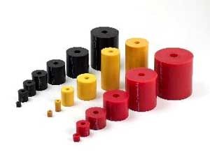

An old elastomer or similar in the front mech cage above the chain will make it even better.
What an elastomer?
Posted : 23/05/2014 9:15 pm
You're new to this, aren't you 🙂
Elastomer were rubber springs used in suspension forks of yore. Basically you use it to fill the space in the front mech mech cage above the chain so it can't bounce off.
