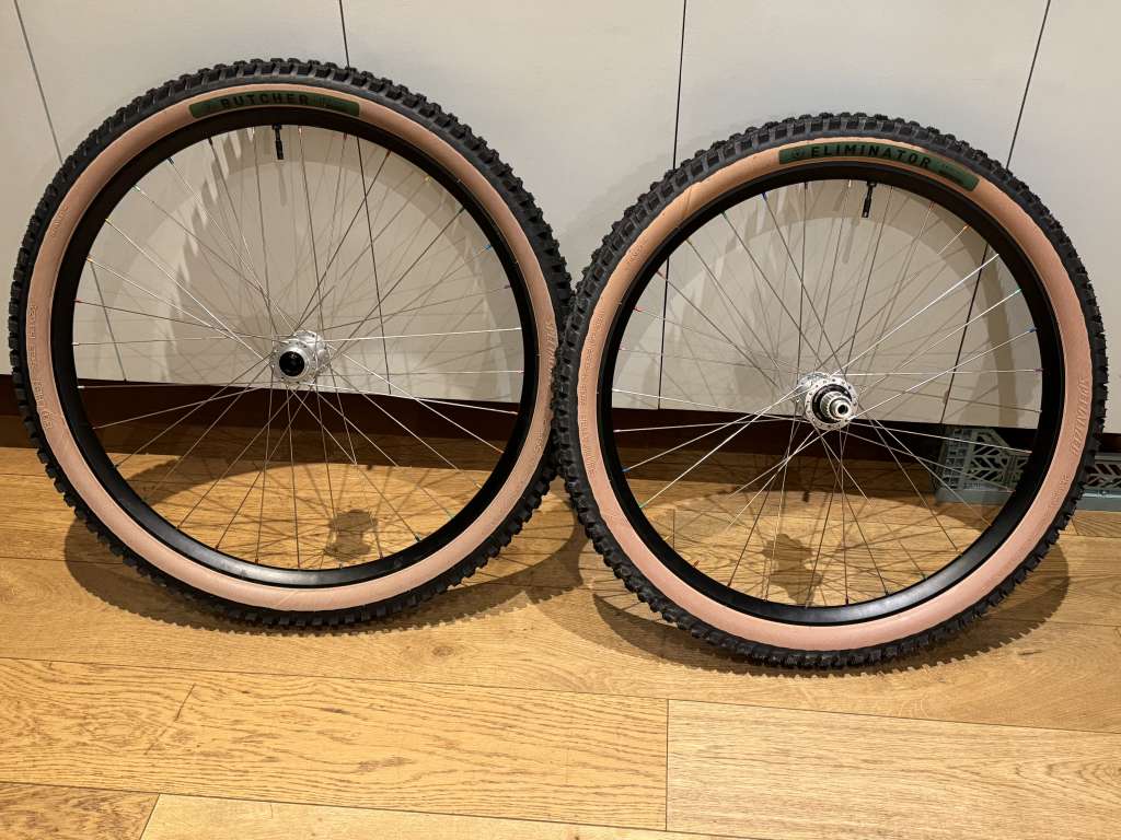

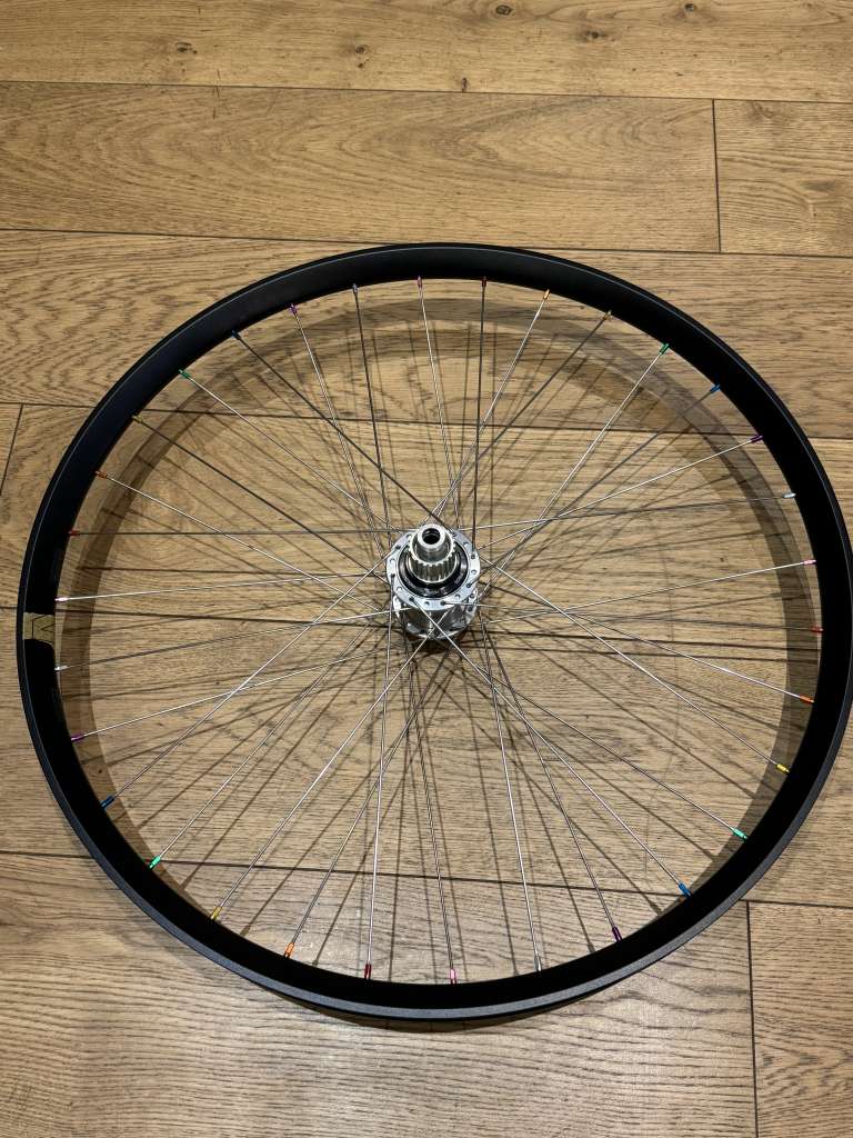

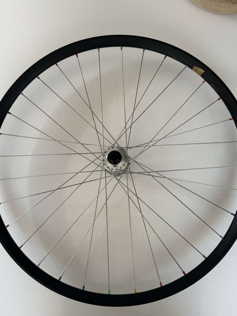

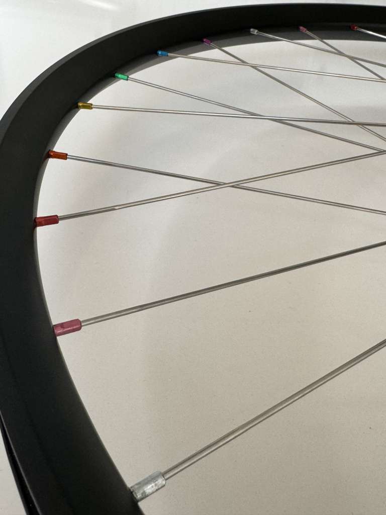

I’m double posting with the thread where I scrounged tools but thought I’d drop some photos here too. My rainbow wheels!
IMG_0679IMG_0678IMG_0676IMG_0675

So what sequence did you go for?
Can't see very well, seems some change from one to the next yet in another pic there's 3 red together.
Posted : 07/03/2024 10:43 pm
Posts: 677
They’re alternating colours every nipple (not in groups of the same colour) I think the poor lighting makes the pink - red - orange all look similar but they’re quite different IRL.
Posted : 07/03/2024 10:56 pm
Posts: 3205
I can just about see that now.
I wonder how they'd look with black spokes.
Posted : 07/03/2024 11:04 pm
Posts: 677
I think the colours would stand out a lot better with black spokes actually. Maybe next time.
