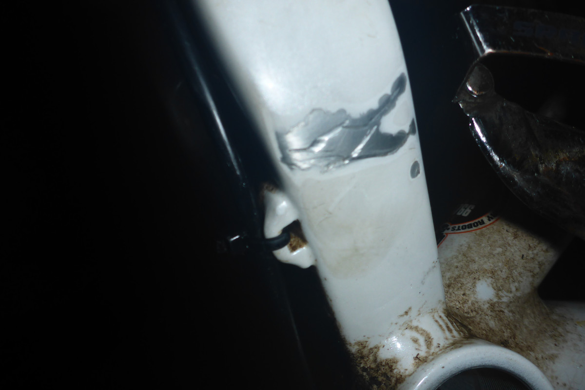

Caused by chainsuck on my much abused on one fatty, Like I say its had a hard old patch to hoe with little care.
Needs a new drivetrain, rear axle, and freehub which is a fair bit of hassle and expense if the frame is going to give out anyway, and this years ice cream trucks arrive in april 🙂
chainstay

I reckon it will definitely crack . . . Eventually.
But that could be next year or in the 2030s.

Nothing I can see there that currently looks like a crack. What happens next depends how thick that tube is I guess.

File the groove/edges smooth to minimise the risk of crack propagation. If you’re still worried, you could give it a carbon fibre bandage to beef it up a little - distribute the stresses. Try Easy Composites for a repair kit: https://www.easycomposites.co.uk/fishing-pole-repair-kit

If it was mine, I'd ride it but check it before each ride.

It's a chainstay? So surely even if it does crack, the bike will just have a bit more compliance on one side than the other.
There is still another chainstay and two seat stays holding it all together.
My full suss comes like that from the manufacturer by design!

Had the same on my Fatty. I just got some aerospace glue, a square of Ali from a can... bit of filler and rattle can paint after.
Been OK for 5 years now.
Did invest in a better front ring as well.
