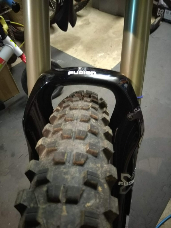

Posts: 6235
So do 27.5” x-fusion sweep
I bought some of these from PX for £233 recently, proper bargain, and they easily take a 2.8 Michelin Wild AM tyre.
XF Sweep
Posted : 13/10/2019 7:18 pm
