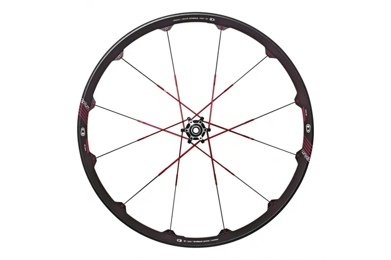

Posts: 3300
like crank brothers?
crank bros

Not certain, but I'd guess the rim needed to be heavier to take the design.
Mavics execution of it was much better, but then tyres got better designed with tubeless in mind (not just UST) so the advantage seemed less.

Posts: 3300
the crank bros ones were a nice idea. essentially a really long alu nipple from the hub. but in reality were a bit rubbish, in part down to rubbish hubs.
the shimano wheels were heavy.
