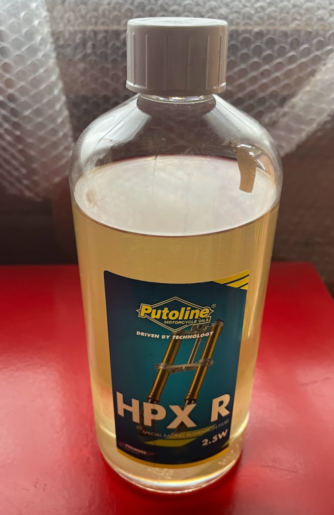

Posts: 4783
I used to think wandering bit point was just something other people suffered from. I have had pretty much every iteration of Shimano brakes and never experienced it.
But on the latest M8100 series had it on the rear and to a lesser degree the front. worse the colder it is outside.
Tried all the various bleed methods (marshy etc) even had the calipers apart etc, check for sticky pistons etc, too the brakes off the bike to allow more manipulation of angles etc. even degassed the shimano fluid.
In the end just put this in and issue is resolved.
HRX
Not sure if it works as it is clearly less viscous, or as it less viscous it is easier to get a proper bleed, or a bit of both.
