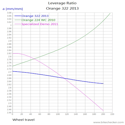

where does this fit in to the grand scheme of things then?
single main pivot (with gert bearings), no fancy linkage to drive the shock, but the lower shock yoke joins the swingarm with bearings, argh my head hurts!

The Shann No.5 is a bit of an odd one. In terms of everything bar the leverage curve it’s a simple single pivot, including the stiffness and loading issue. I don’t think the yoke modifies the leverage curve much, just flattens it a bit (keeps it more tangential to a circle drawn around the main pivot) but it makes a lot of sense for manufacturing in 4130 and keeping a full length seat tube for long droppers.
Posted : 13/01/2018 5:02 pm
The yoke just makes the shock (effectively) longer to keep the leverage rate constant-ish, maybe even decreasing it towards full travel. If the swingarm was made so that it connected directly to the shock in front of the seat tube the leverage rate would increase through the travel and the shock would 'feel' softer as it moved through its travel (and it might even flop over centre).

Science officer, don’t be so aggressive and insult me. There’s no need. I’m not biased, and if you listened to your own advice and read my posts properly you’d see I said that suspension design would be low down my list nowadays. My next bike is unlikely o be an orange or starling, but not because of the suspension design. Anyway if you can’t engage in a debate politely without insulting I’ve got better things to do with my time. Again if you read my posts properly you’d see that my view echoes Chief’s (as you say yours does) about all designs being a set of compromises for the consumer to choose from. It’s just that the buying public have been convinced that single pivot are crap and outdated.
Northwind, yes I think the falling rate was a bit crap, but have they not resolved that now with a new shock placement?
Posted : 14/01/2018 8:39 am
Posts: 13942
Yes, that’s why the downtube is now pierced for the mount. Makes a big difference:
Posted : 14/01/2018 8:44 am

Littleman - Member
Aye, they managed to build around it after about 15 years. Though it's still pretty restricted and added a ton of complexity to the design
I thought the 225 was an interesting move tbh but nobody bought it because it was ugly and not a "proper" orange.
Posted : 14/01/2018 2:38 pm
