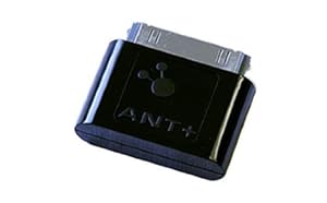

Sorry me again.
What are people using to connect to an (newer) iPad.
Apple Lightning Adaptor
Wahoo ANT+ Key
Posted : 30/03/2016 10:41 am
Posts: 71
The P1 cleats work fine with Keo pedals and Keo cleats seem to work perfectly with P1's from my experience
I agree, I put the 'Powertap' cleats on my winter shoes, and have normal Look ones on my normal shoes, not noticed any difference. I know DCR said worn Look cleats posed a potential problem. Mine aren't too bad so far. I can't see me using Keos other than very occasionally now, so I'll likely just buy the Wellgo ones when mine wear out.
Posted : 30/03/2016 10:59 am
I think the Wahoo key is the only one supported by TR.
I just replaced by PM and HR monitor with ones that supported BLE.
Posted : 30/03/2016 11:59 am
