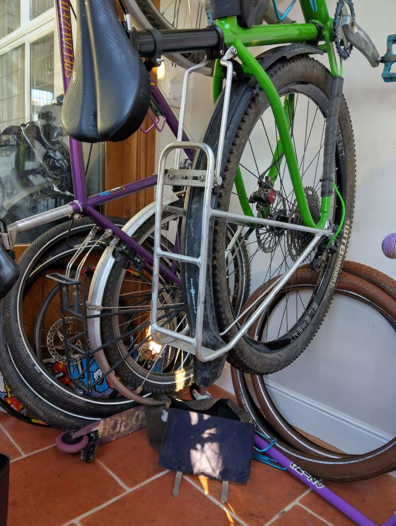

Posts: 1732
Picture of well used Tortec rack fitted to seat clamp eyelets and even older Blackburn MTN rack fitted to frame eyelets behind.

Posts: 1732
Both those racks in the picture up there have been slightly stretched/bent to fit using spanners, vice or just pull apart by hand. To me this is a normal part of rack fitting. The green bike is boost hubs and needed longer bolts so the rack had to be pulled apart a fair bit and then feet bent vertical. It was previously on my old audax type road bike the had narrow 130mm axle hubs. Just adjust to fit.
